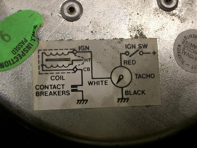

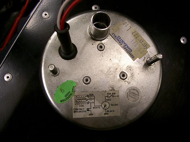

From the diagram on the back of the rev counter I deduced the rev counter was 'Current triggered' & wired the MSD tach adapter accordingly. The rev counter worked fine for a couple of short trips (40 odd mile in total).

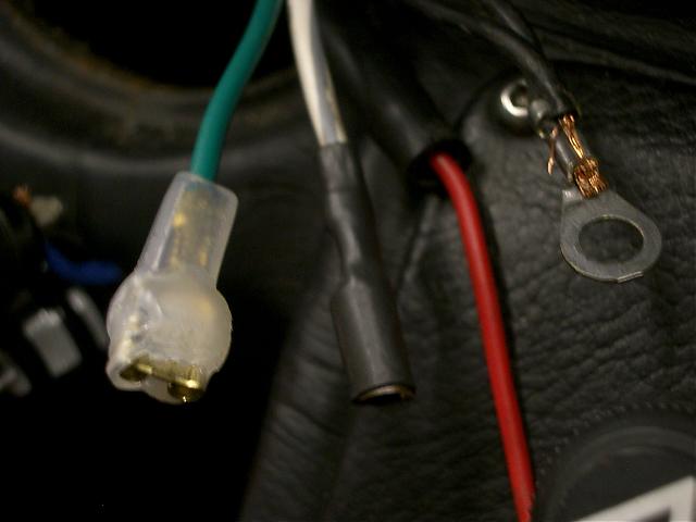

I did a close inspection of the wiring last night & it looks like the red wire from the back of the tach (which goes to green in the GTD loom????) has shorted.... however with the ignition on, both the green & white/grey wires show 12V.
I'm guessing that due to the short, something has fried... question is, is the tach adapter fried, or the tach??

When you day there is a short, how did you measure it? - resistance to earth? It cannot be a true short to earth as it goes to +12v when the ign is switched on?
I have not come across an 8910/20 that has failed thus far, but have a few tachos. Additionally, I have had several 6ALs where they operate ok but their tach outputs do not... Just a thought..

I guessed it was a short due to the insulating sleeve on the green wire being slightly melted.... I'm not sure if you can see this in the picture above.....

I guess then that the tach itself is fried... Is there anywhere in the UK that can repair these, or is it a case of replacement??

Before you go the step of replacement, I think you should confirm what caused the current tach to take a crap. Are you sure it was the insulation on the green wire?

Also, the slightly melted insulation on the green wire could have been caused by a slightly loose connector, which in turn would be a bit resistive and then get warm/hot when current is drawn across it. So check for tightness of connections there too.

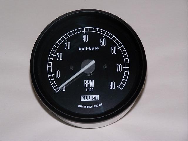

Just to finish this thread, I decided to go with the elliot tacho rather than mess around with the old GTD unit.
I ordered direct from the manufacturer & they were a pleasure to deal with. I would happily reccomend them, great service, great price & a really nice tach, details at Elliot Design
the unit fitted right in the dash, no problem & is wired straight to the MSD 6al, thus not needing the tach converter.
