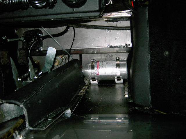

Jack
See pic of front compartmment of P2125...Look real close to left of storage box and tubes coming out of tunnel and you can see the Firebottle bracket and discharge tube ( bottle wasn't installed when pic taken)....Steve

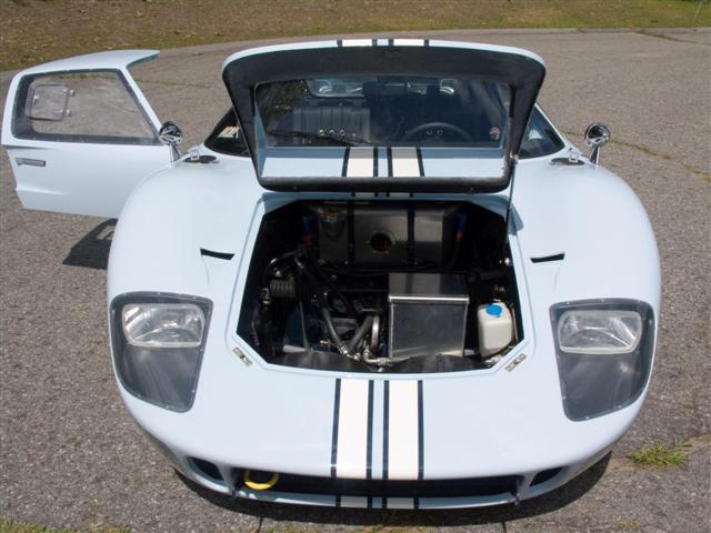

I don't know if an SPF has the same amonut of room a a CAV but here is where I put my system. There is quite a bit of room in the CAV.
