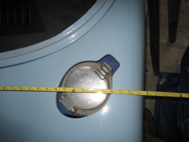

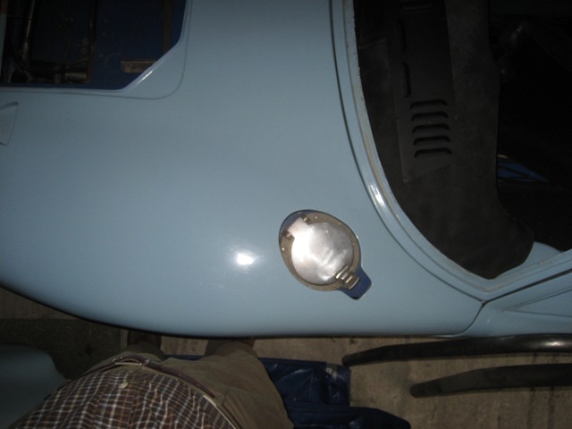

My car is a GTD with KVA bodywork. I have attached a couple of pics which show the position of the filler cap on my car. Hope this helps.
