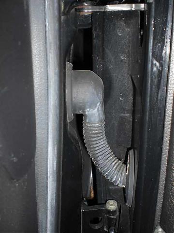

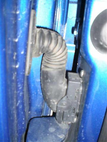

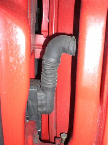

Something like these? Scenic, clio and 206.

Dave, I used items off one of the higer spec metros from a breakers yard. I found them to be the longest length I could find and had larger sections at the end which stop it pulling out of a 1 inch hole. I drilled into the end of the door so the rubber is elongated when the door is closed.

Thanks guys, that gives me some options to look at. In Simons pics, the second one (Clio) looks about right, and the Pauls longer Metro one could be good if the Clio one isn't long enough. So I will check the length I need, then check out metros and clios in the breakers yard.

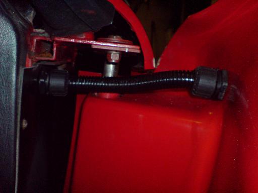

Well, with no let up in the rain, I gave up on squelching around in the scrapyard, and got some convoluted tubing from Vehicle wiring products in Derbyshire. The tubing is nylon, so ought to last, the other thing I liked was the bulkhead fittings which seal well and have a self locking tab to prevent loosening. Shown in pic with door fully open.
