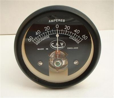

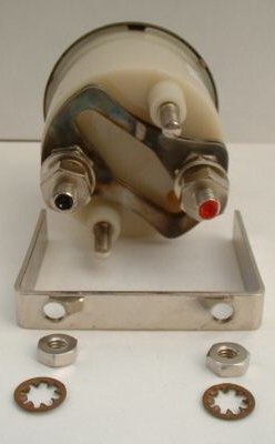

Does your CAV 60A Ammeter have or use an external shunt or is it directly connected?
Thanks, Steve
Doc Watson
To be honest I dont know, how will I find out????
Andy
Hi Doc
The big bit of metel across the back of the meter is the shunt (not the fixing bracket) hope it helps

Thanks for the pic (just what I wanted to see) and thanks Geoff for the ID of the "shunt".

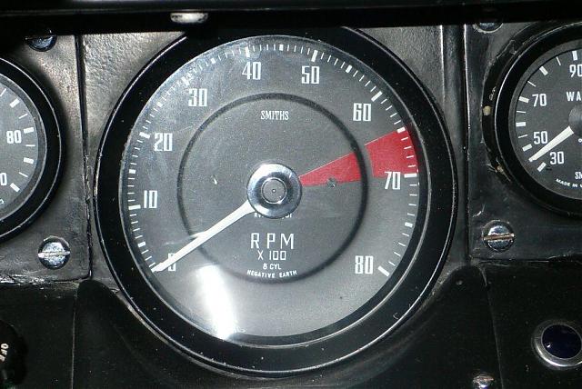

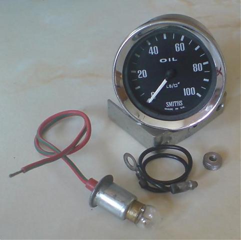

No there is no light but I will be putting one in myself. I'm taking the assembly apart to paint the inside of the gauge red as per originals and while doing that sorting out the drilling of a hole in the rear for a bulb and holder. Also the gauges (apart from the ammeter) all need a 'Chinese hat' added to the needle holder which is a 6-7mm plastic cover (see the rev counter photo, the needle centre has a disc on it which looks like a chinese hat) which prevents light shining through the needle assembly on 'normal gauges' although looking at the ammeter there is loads of empty space where a back light could shine through.... might need to rethink the ammeter lighting. Picture of my oil pressure gauge with back lit bulb and holder, ammeter will have similar bulb and holder. Also pic of 'chinese hat' in original rev gauge, and original cav ammeter which just shows the red internals.

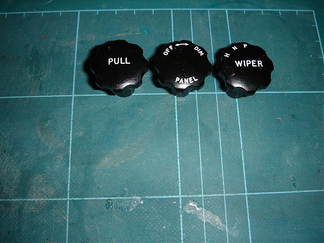

Steve, all gauge bulbs are wired seperate to the gauges and have a small knob which is used to increase/decrease the intensity of the bulb lights so are wired together as a group. The circuit is wired to a switch (see photo, middle knob) which turns on and changes the gauge bulbs intensity.
Discussed bulb for ammeter in the other thread, sorry had a wedding reception friday, and work saturday.... if your gunna have a hangover at least get paid for it.... so late replying hope this helps.
Photo of dimmer knob shown.
BTW the 'Pull' knob is for activating the martin baker passenger seat ;-)

Looking at rear of case I guess you plan to mount the light socket in middle of case and UNDER the shunt? If so probably best to use a plastic socket as a metal socket will require a case ground and if comes loose could bridge the shunt and short out the gauge light ckt but, you probably already figured this out.

I understand need for the "Chinese Hat" to direct back the light coming from behind the gauge face but, as you said the CAV gauge has lots of open space around the gauge face for light scattering so I agree the hat won't be the fix. How about either coloring the bulb ( I have used a red dye in the past) or more recently I have used a plastic "condom like" red boot made for this purpose sold in AUTOZONE stores here in the States?

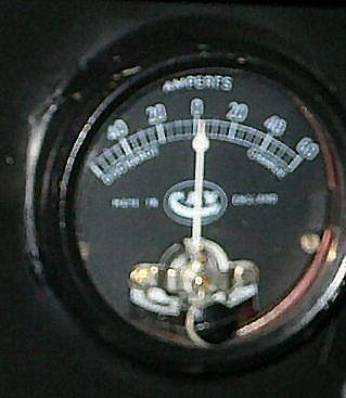

Your pic in post of 5:31PM shows a CAV gauge with what looks to be an adjusting slotted screw head at bottom of gauge glass (is it glass or plastic...I'm still waiting for my gauge so don't have it in hand)...Is this for "zeroing adjust?..Wonder why ones now available don't have this feature or is it for something else?

Back in the day when I had to run around in the dark with a gun and a map we used to buy cheap torches and 'pen in' the lens with permenent red pen, I agree that it would be prudent to do this to the bulb in the ammeter. Also with regard to placements of the bulb, I havent taken the thing apart yet to paint the interior but the bulb would be either on the lower back or possibly mounted on the side at the top...time will tell. The plastic is of good quality and I dont see any problems with painting the interior or drilling for the bulb holder, will just need to wash the plastic in soapy water, lightly sand, wash again, dry and paint.

The photo of the original does have an extension on the zeroing screw, I will probably keep mine as is but check its zeroed before I refit the glass after painting.
