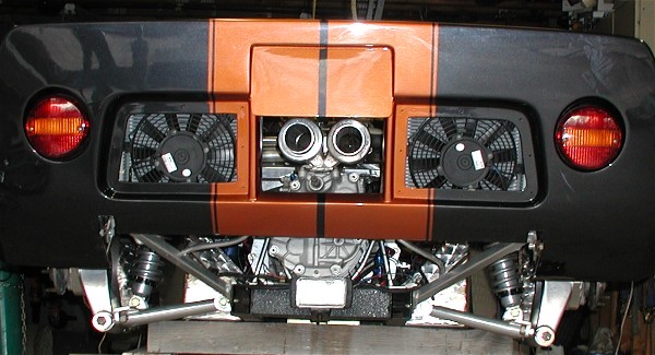

This is where I put mine. Lower left of gearbox cover. This is one of two standard GTD reverse lights. I don't know what they come from.
Anybody?

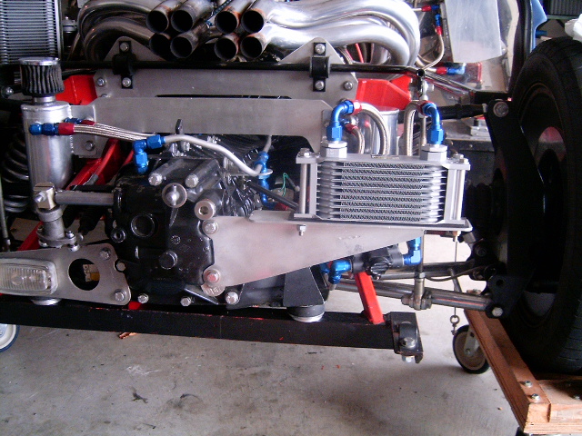

Here's mine. Added a piece of steel to the rear frame, undercoated all and put the light on it. Got it from either Car Builders Solution(several types to choose from) in England or from Harbour Freight Tools.

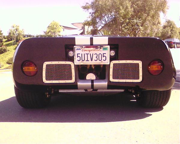

Put mine on each side of the license plate.

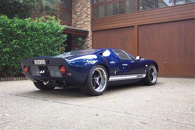

Brian, I used Hella #1403 reversing lights on mine - nice rectangular units (about 3" x 4") with a good quality chrome finish & a useful bracket for mounting.
I glassed aly brackets into the rear clip, just below the lips of the rear openings, bolted them on, then put my mesh covers on.
No! says the engineer - no mesh allowed. So I just took the mesh covers off for the rego checks & all was ok. Stupid rule (but don't get me started on those) - you only need 1 light, but I had 2 - even with the mesh covers on place, I had about 1.5 times the light that you would get from 1 light & no covers - but that didn't meet the "rules". So after rego, I just put the mesh covers back in place - heaps of light from the reversing lamps, & they are subtley hidden behing the mesh. I doubt that any "Constable Plod" will pick me up for the mesh (too many other juicy targets on the car !).
The attached pic just shows the rectangular lights behind the mesh.

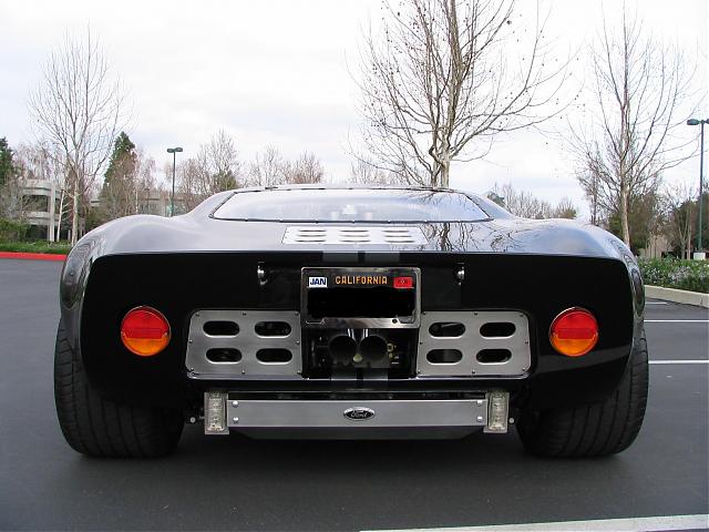

Here's the new(BMW) mini lights on my roadster.
