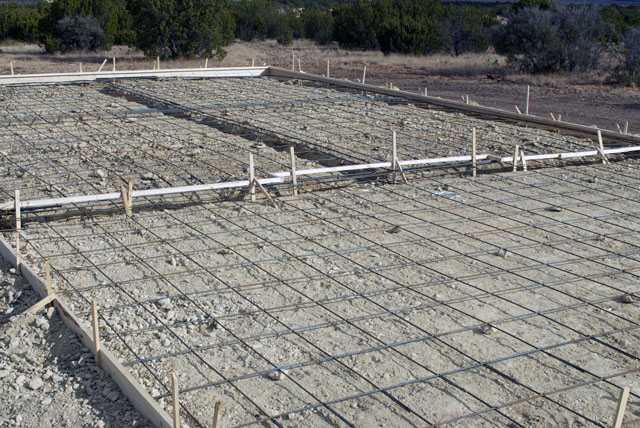

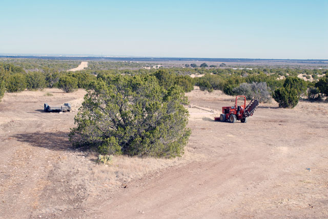

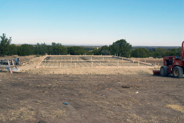

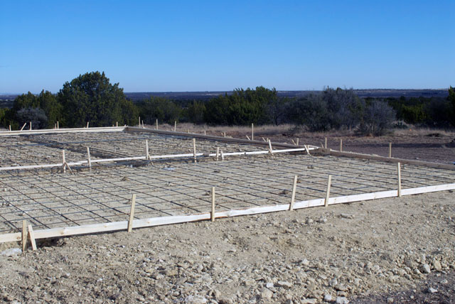

We just got started on my new shop. Overall, 30' x 60' divided into a covered 20' x 30' front and enclosed 30' x 40' shop. It will be red steel welded, insulated, roll-up door, bath/shower room, skylights, eaves vents, 110V/220V all around, stationary compressor with piping and drops, 2-post lift, epoxy floor, outside 220V welder plug and water on porch.

Dang you've got a big back yard! I can't even see the fence!
Sounds like my kind of place....

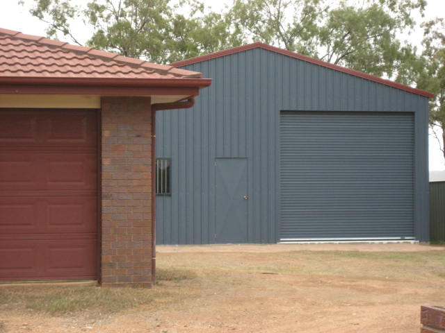

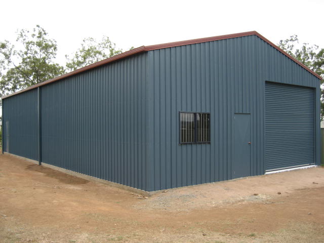

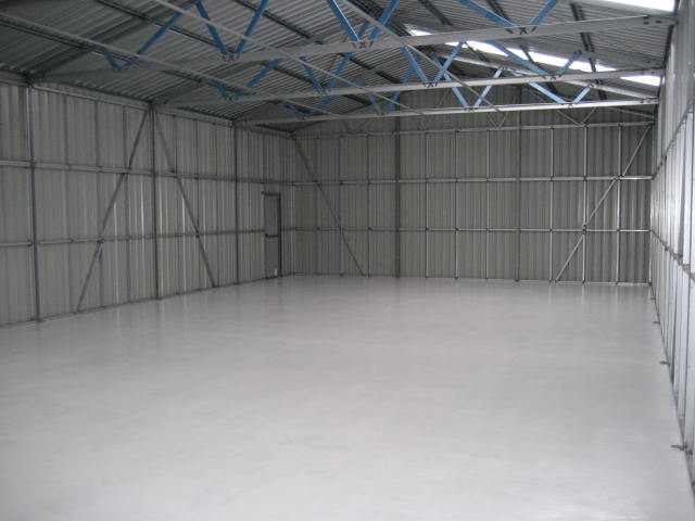

Yeah, man cave! 30x60+ height. Insulation is a must in these things as its like a fridge in the winter and like an oven in summer.

Mine will have 12' walls and 3/12 roof pitch.
On my little shop in Lone Oak, it was originally a storage building of about 22' square, all metal and non-insulated! So, I bought a spray foam insulation kit for a DIY job. OK in theory. But the instructions said the nozzles were good for about 3 minutes EACH and I had 3 nozzles! Everything was draped (thank God) including the floor. I wore a "bunny suit", goggles, gloves, old tennies, dust mask and got to work. I needed 2 1/2 kits so I had nine fan nozzles. The walls went pretty quickly. The ceiling was a different story. I had to go up and down a ladder, moving the ladder along the way, dragging the twin tanks along, changing nozzles AND enduring a "snow storm" of foam bits. My goggles were blanketed in just a couple of minutes and everything had a dusting of foam bits!
Note to self....."next time hire this out"!

Chris,
I see you have plenty of work space, nice! I will have a center roll up door and an I-beam will run the length down the center line to hold a trolly.

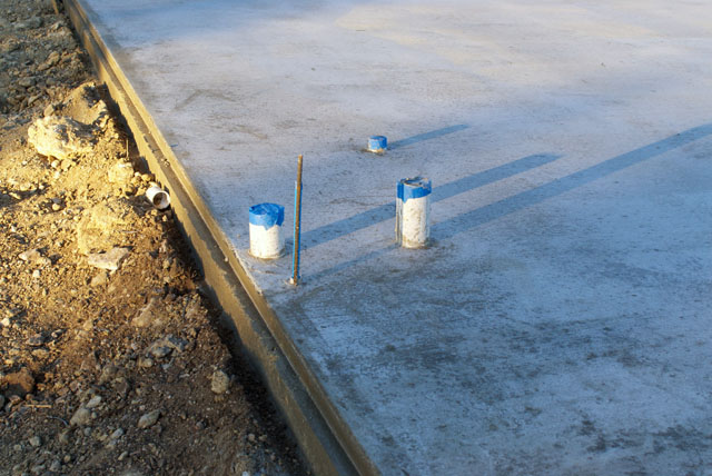

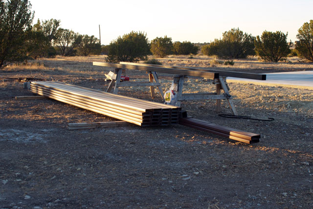

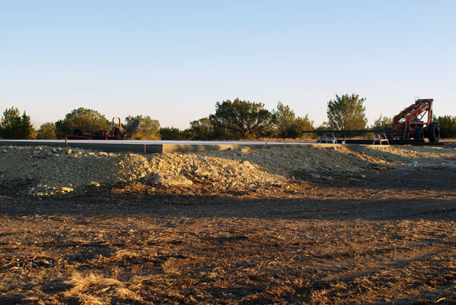

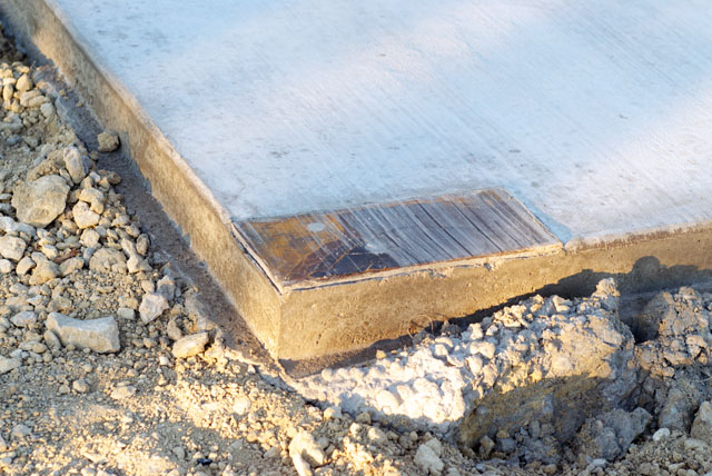

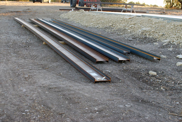

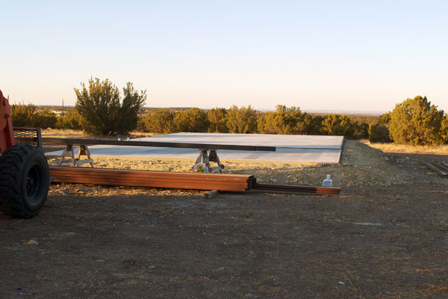

A few photos: There are Plates in the slab for each post. All welded red steel posts and beams. The longest I-Beam will run the length of the shop for the trolly.

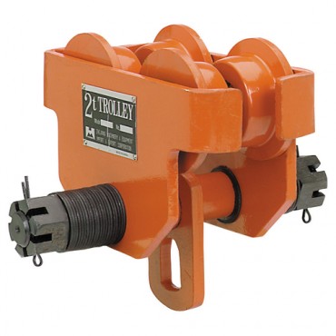

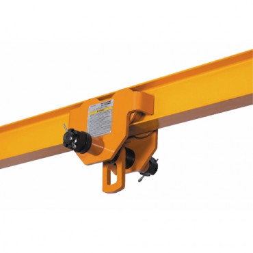

Little update: Met with builder Sunday to go over some details/changes. One change will be to change to opening ridge vents rather than eaves vents. Going to use boxed beams rather than C-beams outside under front porch to keep birds from nesting inside C-beams. Gutters will go to 55-gal drums (my "green earth contribution" ) for water catchment. I purchased this 2-ton trolly from Harbor Freight to run along the center ridge I-beam.
