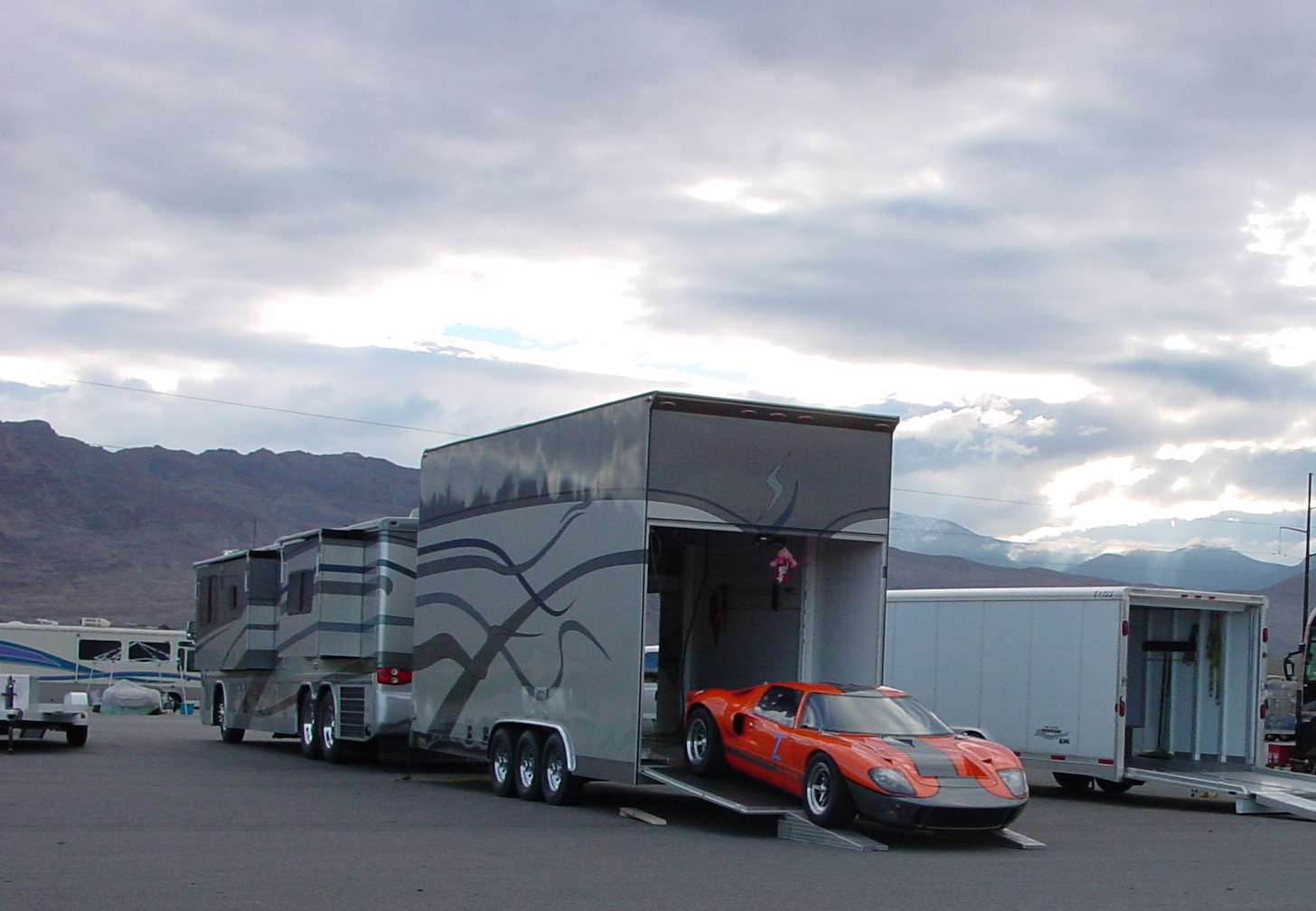

P-nut's right, California maximum legal length (overall) is 65 feet. Majority of coaches are 40 feet, so a 20 foot box trailer (plus 4' tongue) lies just under the limit. With that said, 'size matters' and how lucky do you feel. Even a 22' box would be overlength in this instance so my thoughts are what's the difference if your 1' or 5' over. In the unlikely event you get pulled over you'll be dropping the trailer and calling for a tow either way. I've had my 24 stacker box for seven years here in Calif and no issues. That's not to say, I do pick my routes and fly under the "radar" whenever possible, the pic below explains why it does stress me a little.
I agree with P-nut that a 24' box is a prefered length even for resale and I've never heard "Gee, I wish I had a smaller trailer" either.
Also, from what I've see the majority of track days are not like Nascar where everyone drives a 40' coach. It's more dually's, pickups and smaller tow vehicles.

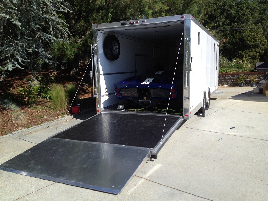

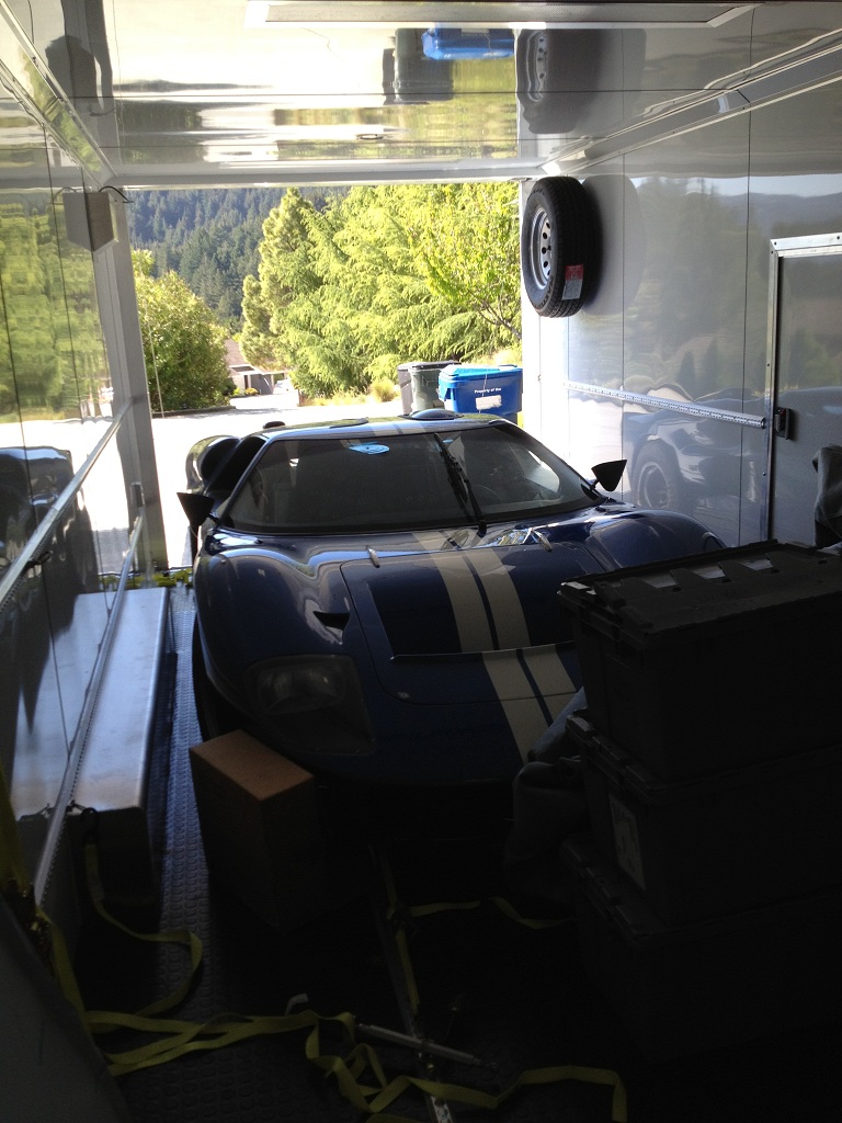

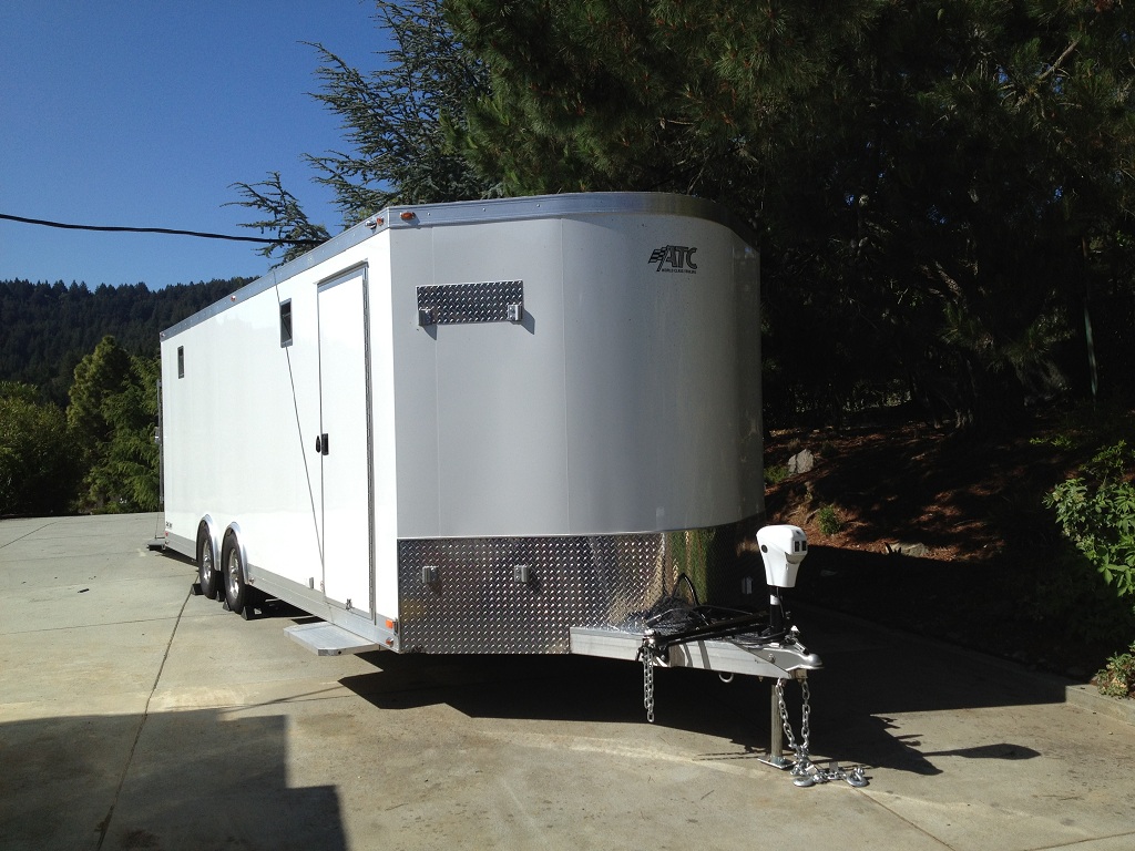

After moving the key elements of the household (P2160, my wife and the four cats) 500 miles north in one 9-hr drive, here are some pictures of the trailer with P2160 still unloaded. Thanks again for the great advice.
Name:	Trailer Front.jpg
ID:	58611 Click image for larger version
ID:	58612 Click image for larger version
Name:	Trailer Inside.jpg
BTW my original color choice was silver to match the tow vehicle, but couldn't get that with 0.050" skin (which I preferred over more wavy 0.030"). So now I'm going to "wrap it." With wrapping providing nearly total freedom, looking for suggestions on a color scheme....

Alan, Good looking trailer. How much does is it weigh unloaded?

Ah, this is where it gets ugly. After having taken delivery I discovered it weighs 4,700 lb empty. About 1/2 ton more than I expected, but then I don't recall where I got my expectations. So riight now i'm curious but also ignorant about how "aluminum" was an advantage in empty weight. :-) I did option the s**t out of the thing, going from a base price of around $13K to $30K, but don't know precisely how that set of options impacted weight. I may ask the mfr. to break that down for me.
But the moral to anyone doing this who cares about weight is to ask about the weight of every single option and track it the way you track the purchase price. Overall I'm not unhappy; my LX-570 towed it with the 2600 lb GT40 and a bunch of household stuff just fine. I just had fantasies (but not plans) of being able to load a much heavier car before hitting my tow vehicle's limit.
Here, FWIW, is the configuration somewhat earlier than final but pretty close to what I got; everything I marked in red would add significant weight relative to a basic trailer so I may just have a "nickel/dime" problem....

That does seem a little heavy for an aluminum trailer. I'm sure its built well tho. My 20 ft. long Haulmark race trailer is 3558 lb. but the interior is fairly spartan with only one overhead cabinet.

Wow... That weighs 1200# more than my 26' Classic Dominator does at 3500#
my Classic was a $9,000 trailer when it was new in 1998. It also has the 5200# axles and alloy wheels, but the frame is all steel, the only aluminum (other than wheels) is the diamond plate decking on the ramp door and the skin itself. Also I installed Rubbermaid cabinets (lightweight plastic - but they are holding up very well), a compressor, winch and a big-a$$ battery under the work bench.
All I can think of was all that bubble-foil insulation you have!
Must be a darned nice trailer though....

Nice set up!
