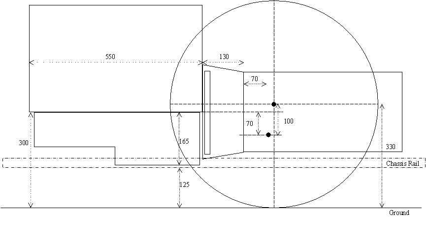

OK. Now I've started on the Trig. The attached diagram shows the problem. The vertical dimensions are accurate, the horizontal ones only approximate but near enough.
What would happen if the assembly with a 165mm sump was installed parallel to the chassis with clearance of 10mm between bottom of sump and botom of chassis rail, and assuming ground clearance below bottom of chassis rail of 125mm using Renault box and 26 inch (660mm) tyres.
The result is a difference in static height between the CV joints of 100mm (4 inches). If we were to run with ground clearance of 100 mm (4 inches) them the difference would be 125mm (5 inches). So ground clearance plus CV difference = 225mm (9 inches)
A 4 inch difference results in a static angle of about 20 degrees, 5 inch about 25 degrees. OUCH!!!
This difference can be reduced by tilting the assembly. Keeping the centre of the engine at the same height (by using a rear pan in the sump) the difference in height of the CV joints can be reduced by approx 8mm per degree of tilt. So with ground clearance of 5 inches, the difference between CVs can be brought down to 2 inches by tilting the assembly by about 6 degrees. If running with 4 inches of ground clearance, this would require about 9 degrees.
Please tell me I've got it wrong. Is this problem the same with the Audi box? What is the dimension between Input and Output shafts

Nice drawing, thanks for taking the time to post it!
I've used almost identical dimensions for my sums! As you say the driveshaft angles are a bit steep, but I came up with a slightly different angle, here's my sums, please tell me what you think!!
What length are you using for the driveshafts? I've measured at roughly 400mm. From the diagram, one end of the driveshaft is 100mm higher than the other.
Using a right angle triangle, knowing one side is 100 high, the other 400 long & we don't know the length of the longest side.
From my trig this gives a driveshaft angle of 14.47 deg. (while at normal ride height)
If you go to full bump, (which I guess at 75mm) then the triangle become 175 high, 400 long, giving a driveshaft angle of 25.94 deg
it's probably worth mentioning that during the change from normal ride height to full bump, the drivesghaft length changes from 387mm to 359mm so a 'plunge' of 28mm would be required.
From the manufacturer I spoke to, this is not a problem with each CV having 16mm plunge.
I have'nt done the same sums with an inverted 'box, but I'd guess the angles would be much better, probably close to perfect! If you're starting from scratch I reckon it would be well worth looking at the Ultima setup.

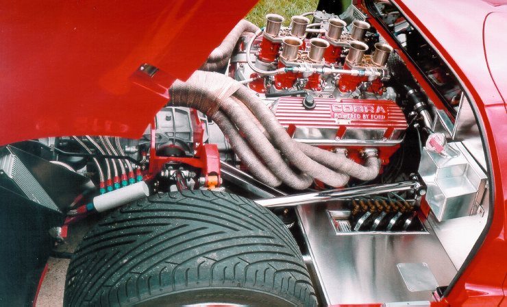

I modified my GTD frame to run a 351W with a Porsche G50-52 with a Quaif and my half shaft angles are less than 5° and the bottom of the oil pan is 4" from the ground. The only problem I have had is breaking half shafts and CV joints (due to excessive HP and torque), but Phat performance in California sold me CV joints and axles that can take almost anything that you can put to them. I also had my toolmakers at work make up adapters (the bigger CV joints have (6) 10mm bolts on a larger bolt circle, same as the Porsche out put flange), which will bolt the bigger CV joints to the stub axles. I was then shearing the (6) 8mm bolts in the adapters so I had to have the adapters indicated to the stub axles and welded, since the adapters were welded I haven't had any driveline problems since. BTW I have made many different 1 off components for my GTD and I can supply prints and 3D renderings for anything that I have modified or made for my car. I have a lot of experience with AutoCAD and AutoDesk Inventor 6 and I would be happy to help anyone with their project.

I'm assuming that to fit a G50, the trans *has* to be inverted, as in the porsche the engine sits behind the trans.
Is this correct & if so, I guess the crank centerline must be below the driveshaft output centerline. Do you know by how much?
I assume the ally pot with the 6 oil lines is some form of transmission oil cooler/pump?

As Julian said, nice drawing. Sorry, I didn't get back to you sooner, I've spent the last 3 days tearing down and rebuilding a friend's diesel injection pump; (lots of fun).
The differences between our two set-ups puzzled me so I looked a bit closer into the details. It might be worth checking one of the assumptions I made in my previous post; ie that the centreline of the crank is on the plane of the base of the block.
I went back and checked this and found that the crank CL is in fact about 1.5" above the top of the sump pan. I am not using a Ford block, so yours could be different. To me, this explains the differences, it also means that the R30 and R21 gearboxes have the same vertical offsets between input and output shafts (70mm).
Sorry if I mislead you a bit, but without having a Ford block in front of me, I had to make an assumption. The good news is that if the Ford block is similar, you will wind up with similar halfshaft angles.
Good Luck and sorry about the confusion if I caused any.

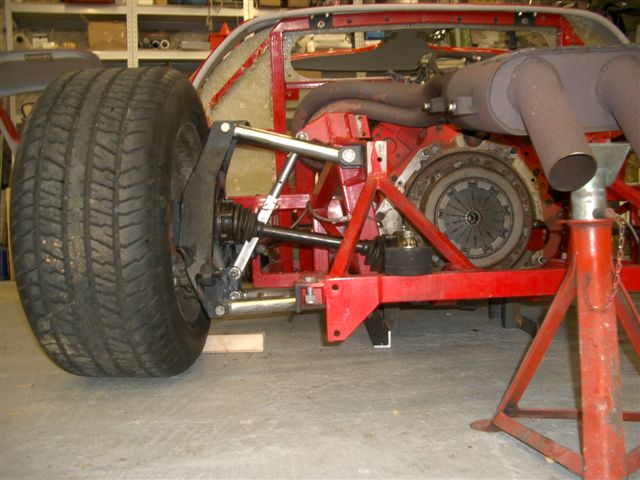

I hope these pictures are of interest. I've made a jig for lowering the engine/tansaxle. Ride height is 135mm & the crank centerline is 165mm higher than the chassis floor.
This picture shows the driveshaft angle (roughly) at zero bump.

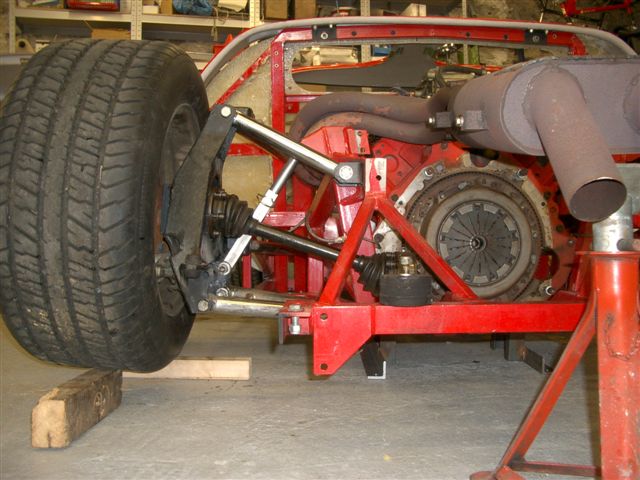

Here's the same setup with 75mm of bump.

Hmmm....puzzling. Just putting a protractor to the screen looks like your estimate of 14 degs at nominal ride height is about right.
I assume the centre line of the inboard cv was placed 70 mm below CL of crank. Those angles do look a bit marginal the way you show them.
As mentioned before, if you tipped the rear of the engine up a couple of degrees (around the motor mounts) you could buy a bit back. I don't think this would effect the lubrication efficiency of the engine.

Yes, the inboard CV is placed 70mm below the crank C/L, & as you say the engine is level at the moment but could benefit from a tilt.
It's worth mentioning that with the engine placed as in the picture, a great deal of chassis modification is required to get the Trans to fit.
Either the longitudinal chassis members that pickup the lower A-arms would have to be changed from box section to angle, or 'spread' the box section by 40mm each and shorten the A-arms accordingly.
The rear section of the chassis would also need to be modified, but as you know 'only' carries the trans mounts & the rear deck mounts.
Or, a third alternative is to set the crank centerline at 205mm & keep the A-arms as original.
Do you have an opinion as to the effect of shortening the A-arms by 40mm? Would this have a similar effect to moving the top pickup as per yours & Dereks studies?
Thanks for your input!
