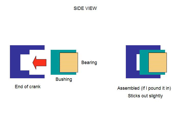

Maybe this will help out. So, I think I should pound it in so that it sticks out and the bearing is accessable from the outside. Otherwise it would be trapped behind the bushing up against the crank.

Good advice from all. I chilled that thing down in the deep freeze and pounded it in the way it is shown in the drawing, seemed to make the most sense. Now I'm just making a clutch tool and will try and get it all buttoned up today. Might be hard with just one person but the hoist should make it reasonably workable.

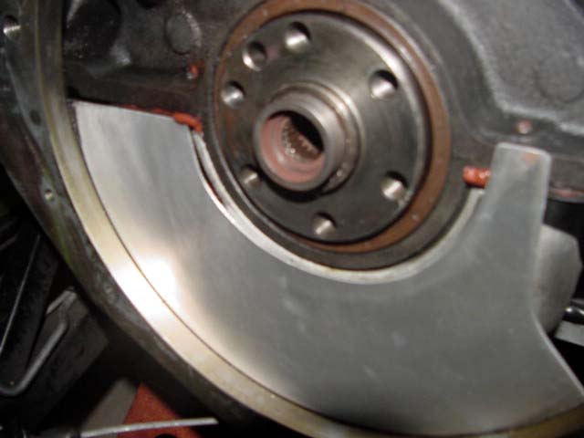

Just for you I tore down the trans to take this photo so you can put your bearing in right. [img]/ubbthreads/images/graemlins/grin.gif[/img] [img]/ubbthreads/images/graemlins/wink.gif[/img]

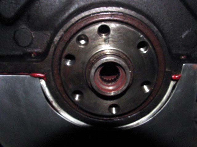

One More....

Hershal, thanks much! Yours is in just the opposite of what I've drawn.
So, the question is, will it make a difference? The way mine is in it will hold the input shaft a little bit further down from the end that yours will. But, it doesn't appear that it would cause a problem with anything.
Obviously, this is one area that needs to be cleared up in the manual.
R
