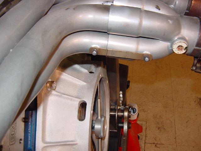

ZF Easy In & Out Modification

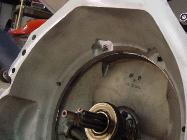

I wanted to be able to slide the ZF out of my CAV while leaving the bellhousing, engine and starter in place. For those of you who have been there, you know that the ZF gets five allen head bolts securing it to the bellhousing from the outside, but it is the two additional allen heads that have to be installed from inside the bellhousing while the ZF is on the floor that pose the nightmare for removal and installation. Apparently everyone swings the engine and trans in as a unit, or pulls it all to service a clutch.
After a few teathing problems and false starts hear are the finished modifications for pulling just the ZF.

The bellhousing is machined to gain access from outside of the bellhousing to the area where the two top allen head bolts were installed from the inside while the housing and ZF were on the floor.

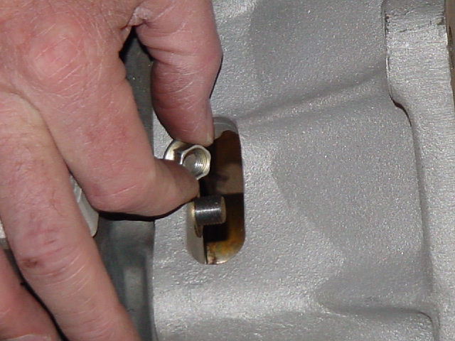

Changing perspective to the ZF and bellhousing on the floor...the slot for the passanger side shows the stud that now is in place instead of the allen head bolt.

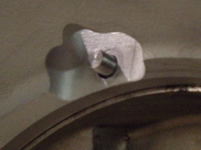

Looking at the same area from inside the bellhousing.

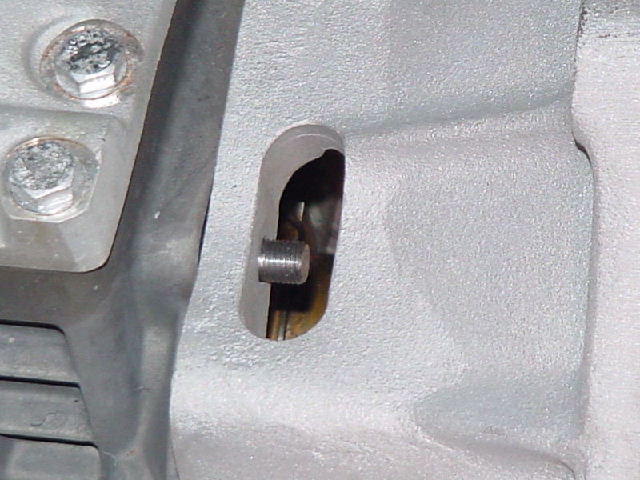

A further close-up shows that the only machining work came straight down from above to give access to the area. The ZF has not been modified, and the shadow of the 10mm allen bolt seating area shows no change to the bellhousing surfaces or thickness.

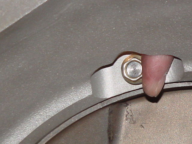

We made the stud to fit the 10mm x 1.5 thread in the ZF, but we made the other end a 3/8 x 24 fine thread. The small head (7/16) of the self locking jet net allows me to use a 7/16 small ratchet box wrench with 4 clicks per throw inside the machined slots, and it clears the headers easily. You can see that the washer has been slipped in place onto the stud. The stud size was calculated to bottom in the ZF, and leave two threads out after the jet nut is seated. The jet nut and stud area are slightly less than the size of the head on the allen bolt they replace.

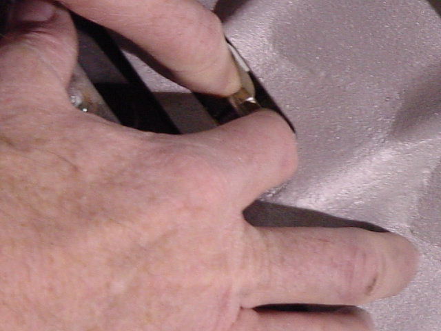

Things look tight, but they are really easy. If you drop the nut it takes ten seconds to swing the ZF out, grab the nut, and ten more to line up the studs and try again.

Lots of room...no problem maaan!
