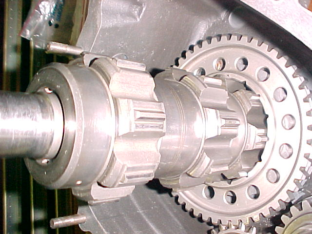

More pic!

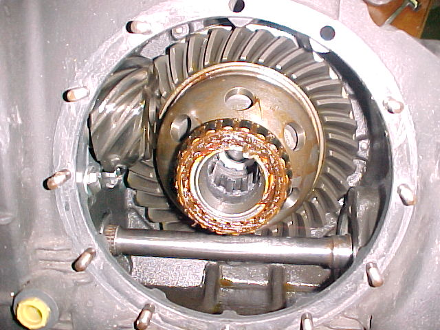

More pic! I found some old pic of inside an LG 500 just the difference is that the hub that carries the dogrings is gearcut to reduce some weight.

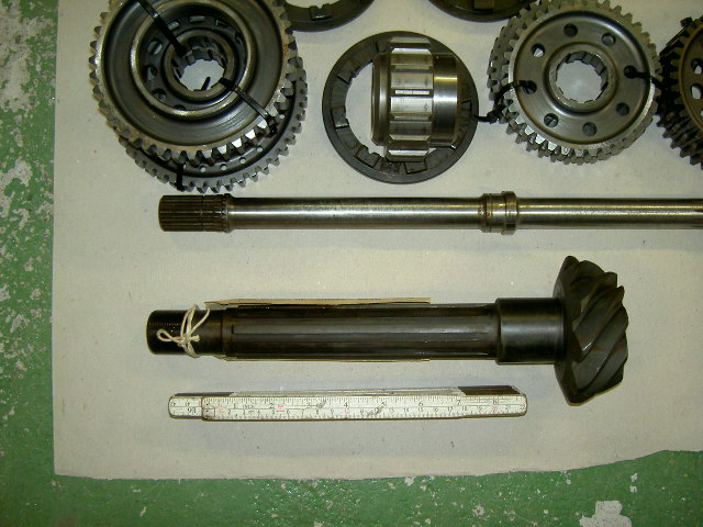

Pic!

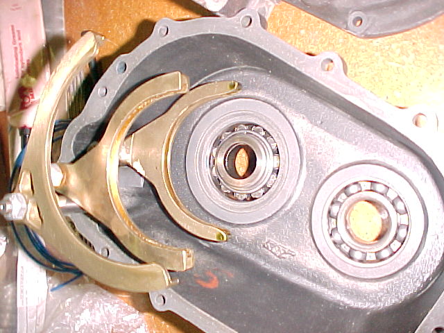

pic 2!

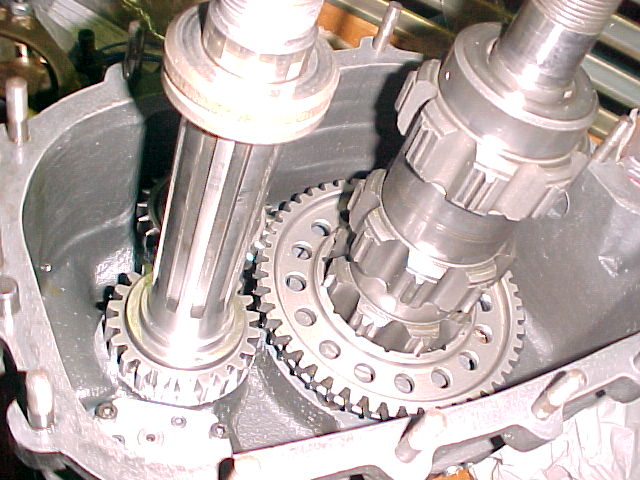

pic 3!
