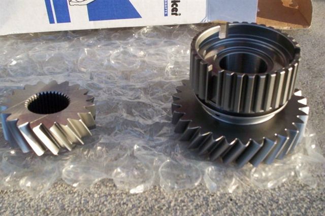

Hi Mike Any chance of a picture, and any thoughs why it would make more noise.

Believe I paid RF $ 520 US. I'm sure Robert can provide
you current price/availability. I'll post a photo next
day or two.
MikeD

RF 5th gear
