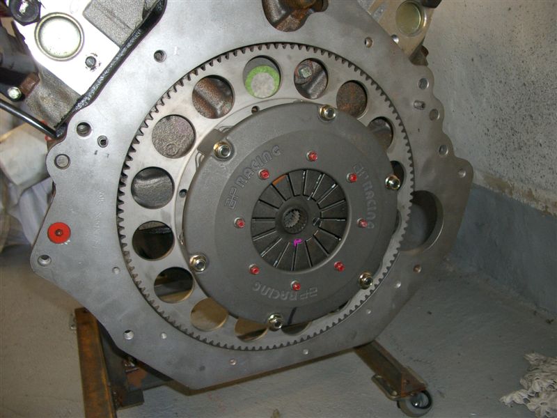

Tim,
here's my 2c!
I see no reason why you couldn't 'adjust' the pedal pressure by changing the MC size.
FWIW I've fitted a 184mm twin plate clutch. It will be noisy & harsh in use & probably have a short lifespan. however I've saved 35lbs in weight over the standard flywheel & clutch!
Part of the reason the 184mm clutch is so harsh is due to the fact it has not got a sprung centre. During my research I couldn't find a 184mm clutch with a sprung centre (with an adequate torque spec).
I'm told that twin organic plate clutches are a bit more forgiving than the cerametallic I'm using.

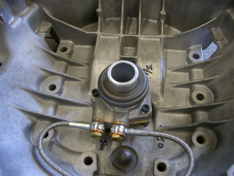

Re the release mech, have you considered using a concentric release? this mech works much better than a 'fork' & has an added advantage of keeping the slave cylinder well away from the exhaust manifold.
I'm a little way off driving my car so I can't tell you how it drives yet!! [img]/ubbthreads/images/graemlins/grin.gif[/img]
Hope this helps!

concentric release mech...

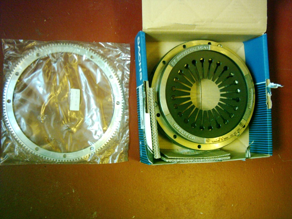

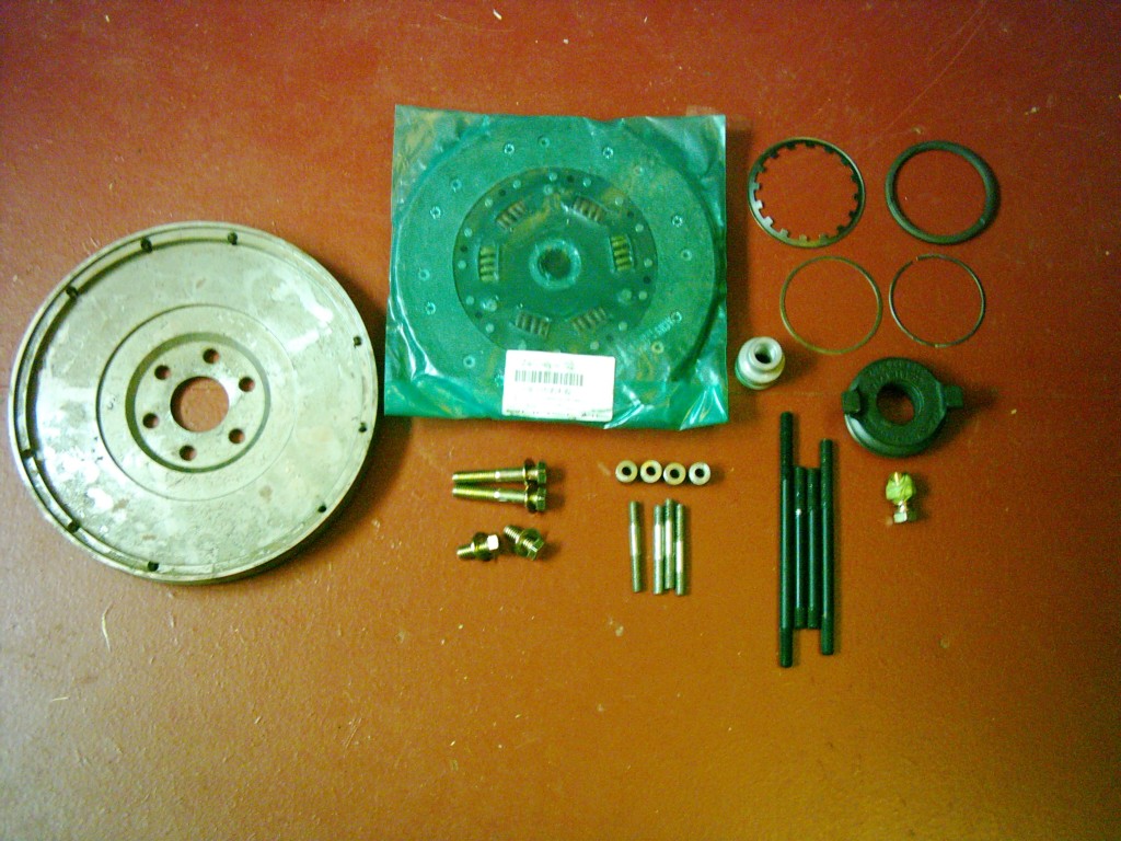

Pictures attached.
First picture shows flywheel, clutch plate, release bearing, crank bush, slave cylinder adaptor and bolts and studs required.

Second picture shows ring gear and pressure plate.

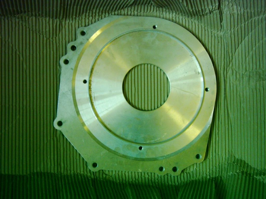

Third picture shows the adaptor plate.

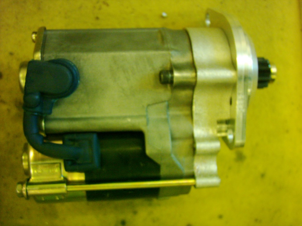

And finally the starter motor which has been suitably made to fit the GT40 just right. Still mounts to the tranny.
