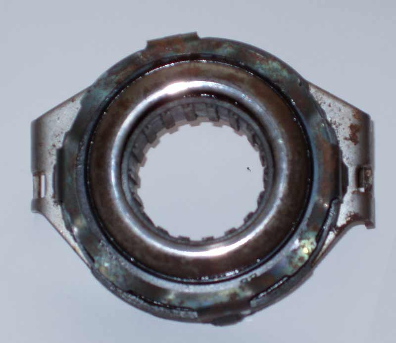

Thrust race ID, pictures
Does this look like a standard Renault item?

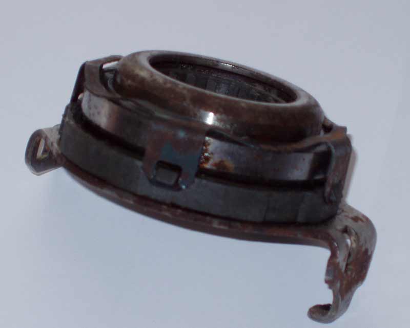

Re: Thrust race ID, pictures
Here is another picture

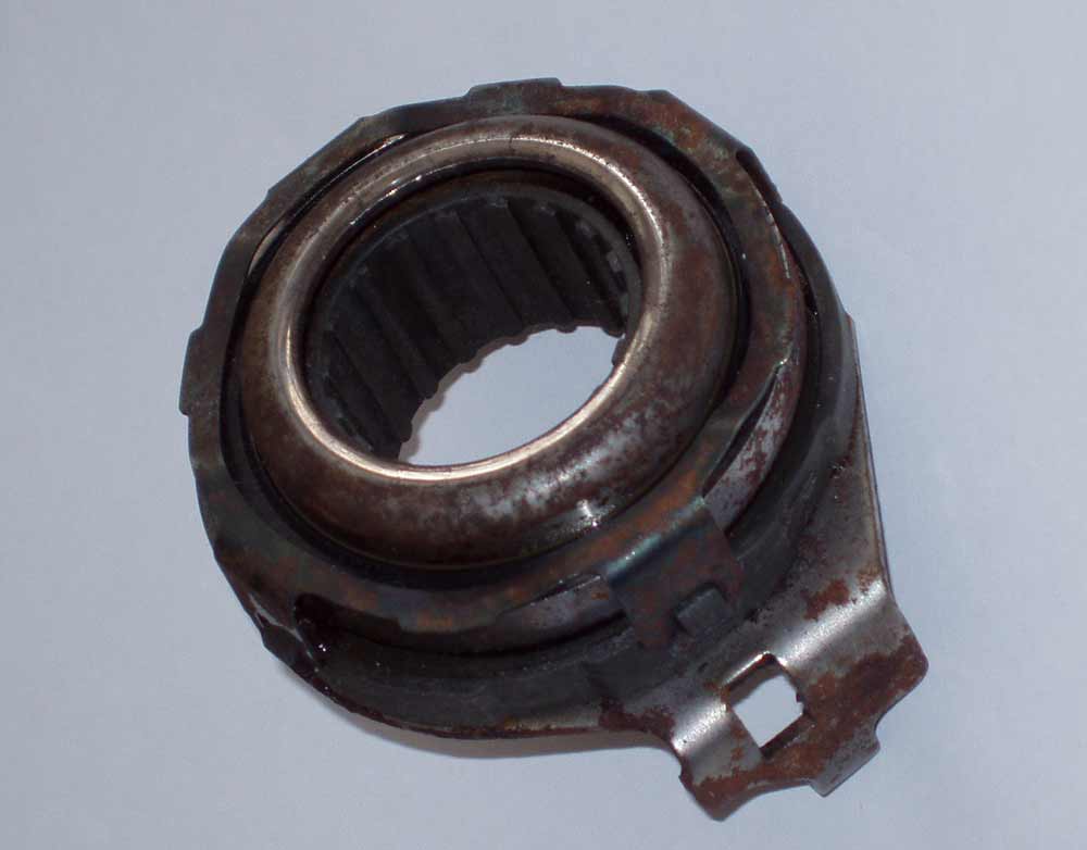

A third

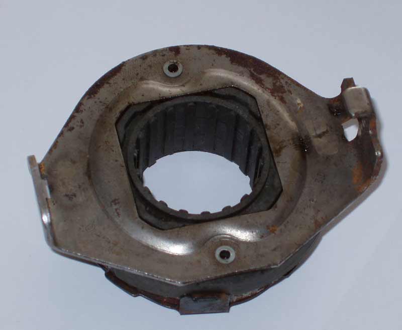

Final picture

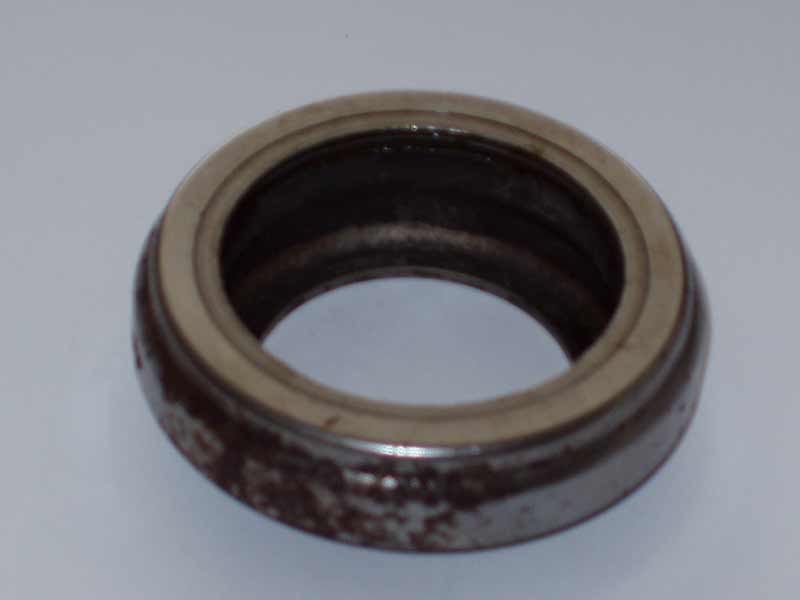

The bearing itself

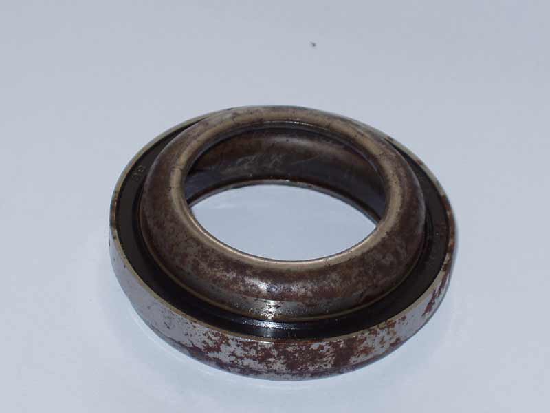

Does this look like a Renault 21 Turbo item?
That's it. I just replaced mine about 2 months ago. I got my replacement from a Delorian parts place.
Be wary of the nylon part. These can overheat and melt. Both Frank Catt and Chris Cole (Mach 1 Transmissions) can supply steel replacements.
Brian.
