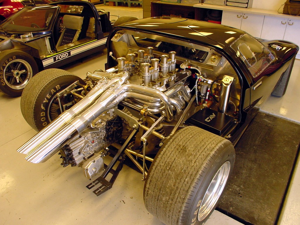

Putting a FE into a CAV with a ZF has been done a few times PDQ, LSMFT. I think Ian Clark at CAV-Canada is doing an FE right now. He is a forum member and you can contact him directly. David Wagner at Classic Motor Sports is a Cobra expert but he did this stunning car in the attach picture. Send me an email and I will give you his email address. Good luck with your car and post some pictures as you progress.
Bob

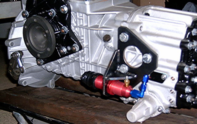

I'd have to say Dave Wagners your man on this one. We will be doing our first FE shortly and will have to work through all the same issues. Great picture Bob, thanks for posting... here's how we did the last ZF. I'm tempted to go with a hydraulic TOB on the next three boxes. Do you have a CAV Steve?

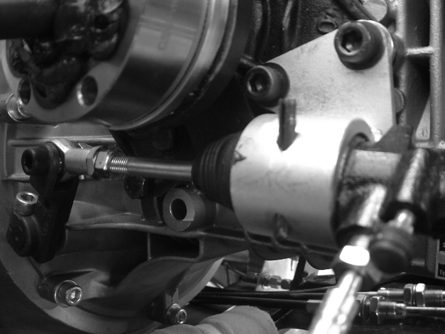

We do have a ZF slave cylinder package. Photo attached.
I can send you a set if you need. Please contact lana@cavgt.co.za
Regards
