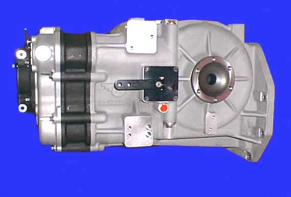

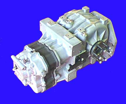

Here ya go about 24 grand.

Side view, NTL-6 Hewland, 500ft/lb sequential 6 speeds with reverce. This gearbox is used in 24 hour sport prototypes. This is serious full on race car stuff. I'm guessing it should be go for about 600-700Hp at race useage. If you need more than this I would contact Hewland and talk to them.
