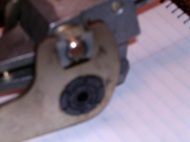

I need a source for the little plastic ball joint holders that are part of the shifter mechanism used on GTDs. I mean the shift lever at the front of the car that you shift with your hand. There are two on each shifter. They control movement of the two shifter arms by slipping over the balls that are part of the two arms that the cables are attached to.
1. For the record what car is this shifter out of.
2. I NEED at least one but I want to buy a few extras.
3. My car is a center shift USA model but I think the shifter is used in all models of GTD's

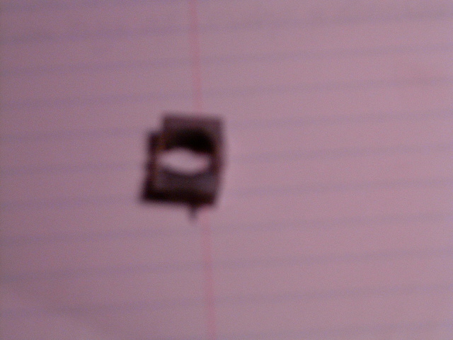

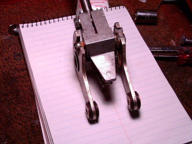

Sorry I have a cheep camera here's a picture of the assembly

Better, Heres one of the plastic piece on the assembly

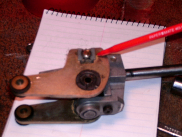

Heres one where I tried to point it out. Well anyway you GTD guys know what I need. Please help me. Thanks, Howard

Thanks everyone, I made one myself last night out of some Derrin (sp?) I had on hand. Kind of a one off, make it by hand, fix.
I believe the best way to address this would be to make some new "L" arms and press in a spherical bearing in place of the plastic "retainer" thingie. The other thing that would need to be changed would be the shaft that is pressed into the main aluminum center piece. I would make a new one with shafts that would mate with the spherical bearing at each end.
For now I will give my homemade fix a try. Down the road, like next winter, I might redesign the whole thing as described above.
In the meantime I am going to try and find a source for the original part. I sent a email to the WC engineering guys. I'll pass on any info I receive.
