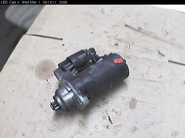

Hello
The toyota starter that kep is using is very rare in sweden, europe?. I am using a very common and used 2002 golf 1,9 diesel starter in my own projekt.Drawing:

The starter in my post above has 2,0Kw power and works with audi stock flywheel ring gear.
