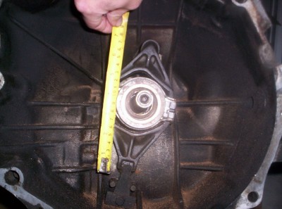

Does anyone know the the ratio of the clutch release leaver on the Audi 016 transaxle. My transaxle is installed so I cant measure it.

Have an 016 sitting in the shed will measure and send pic if you like tomorrow. [img]/ubbthreads/images/graemlins/smile.gif[/img]

Looks like the lever itself is 175mm long from pivot points.
The pic is not as good as I hoped but it may help. [img]/ubbthreads/images/graemlins/beerchug.gif[/img]

Many thanks Dave.
What engine are you using with your Audi transaxle?
I mounted my transaxle to a 302 Ford. I made my own adaptor plate and aluminum flywheel. I have the drawings if they would be of any help to you.
