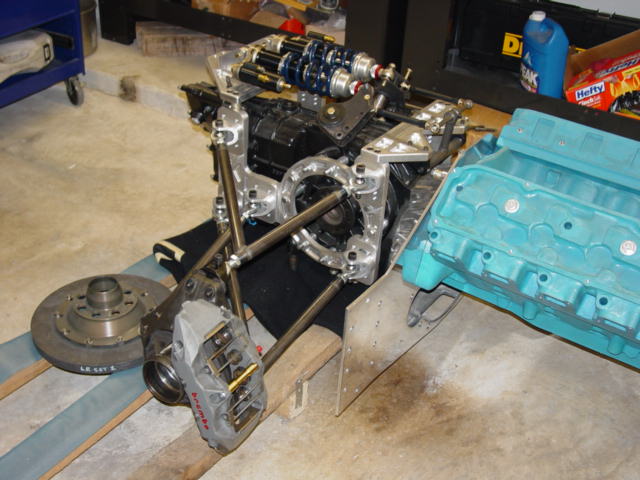

I voted Hewland for my LG600 Mark II, here is a picture of it with the suspension bolted to it (this is just a prototye).

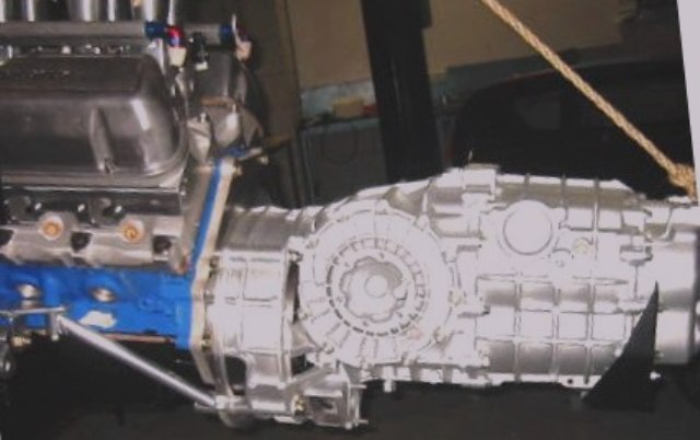

Supportive pictures of the various set ups is good-- 'specially Richards and this G50
