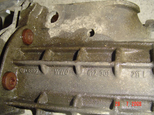

I have a similar problem.
I just bought an Audi gearbox for my GOX GT40 from a dealer. He said it came from a 1996 A6 2.6L, and that it is a 5 speed manual 01E box.
I'm sort of having my doubts about that as it doesn't look like the 01E's I have seen in pictures (example: Comparison of Audi 01E vs 016 transaxles ).
My gearbox have almost the same numbers as ynot90's gearbox, at least the ones I could find.
WWO 012 301 211 L GERMANY 3
(Doesn't the "012" mean that it's a 012 gearbox?)

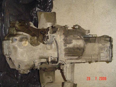

I seem to have forgotten the question in the last post.
Can anyone please tell my what kind of gearbox this is and is it usable with a Ford 302 (under 300 HP) ?
Added a picutre.
this is the view from the top of the gearbox.

Old 07-29-06, 05:56 PM   #7 (permalink)
John W's Avatar
John W
6 Tenths
Join Date: Jan 2005
Location: Surrey, England
Posts: 629
Rep Power: 11 John W is a splendid one to behold
Its defintely not an 01E box, as they have a cast iron gear casing (look at the black bit in the link you posted). Also, the gear linkage looks to be coming out of the box in a different location.
I will have a look on the VAG parts list and see if I can find what it is.
What does the paper label say on the top ?
If you roll it over, does it have a metal tag attached to the bottom with a partnumber on it ?
The number you see is the casting number only, whereas the tag would have the actual build configuration of the box (which make/model of car, and so which gear ratios).

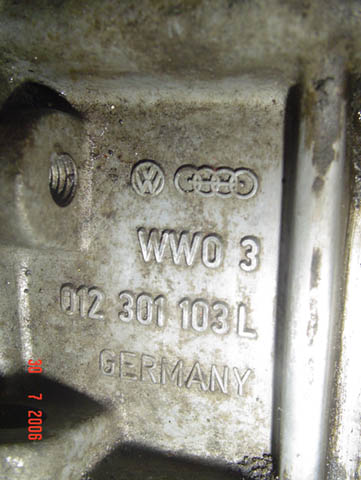

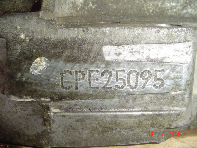

Found a couple of other numbers.
One of them is almost identical to the first one I posted, and the other one looks like the one you wanted:
WWO 3
012 301 103L
GERMANY
CPE25095

012 gearbox
hi espen, I did some digging through some saved pdf and i think this is what you have This particular
gearbox came
from an
1995/1996 Audi
A6 2.5 TDi. This
gearbox type can
also be found in
VW Passat's as
well as Audi A4's.
have a look at this site it may help http://www.v12diablo.co.uk/gearbox.htm as this looks like what you have, and there is some usful tips.
also have alook at this site it lists most of the audi late model boxes, http://www.dieselschrauber.de/audi_zuord.html unfortunatley not yours but most of the 012 listed range from 61 to 81kw it may also help another member find some info
Regards
Lambo
