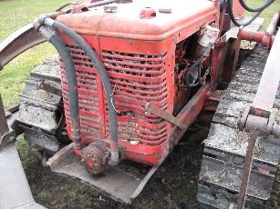

A quick reread of your post Jmac leads me to believe that you think I am mounting the trans ahead of the quick change when I am actually rear mounting the trans. As for torque this is something that I have thought about and have a few ideas on how to adress. Some of my ideas are out there but this will not cost me a lot of money to prototype.I have a friend who runs an A fuel dragster and things like 300M shafts and the like are not that hard to come by as he has ordered this stuff from both prints and from sending in a cobbed together shafts for them to reproduce.Mr earp I also seen the belt drive idea and I feel that its not practical. I honestly believe that I can come within about 2 to 3 inches of the bellhousing to center of output based on the pics I have seen.If you look at the input shaft on the quick change then you will see that the engine position will be very low indeed.

By the way ignore the pic I just threw that in to see if I could so I could show you some drawings later.This is my other toy that I use on the toys that dont work. Kind of like monster garage.

No, I had you right the first time Going by the size of your dozer you have not made any 'Big' mistakes --yet!
