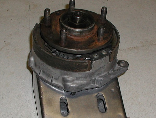

Chris,
You are correct that there is already a built in option with the Corvette. It is simple and straight forward. There is a lever that the cable attaches to that expands the brake pad to hold the rotor. The small hump at the bottom of the drum section is where it hides.

The Vette drum setup is 1984-1987.
Many (including me) use the 1988-1992 caliper instead which uses a lever/cable instead of the internal drum/shoes.
This requires some different pieces, but all are readily available.
If you have C4 parts you must have either the drum or lever type.
Here is the newer lever type. Post a picture of yours if you can.

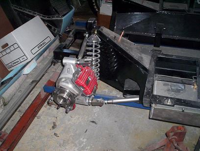

I tried to post pictures of my C4 hub which is attached to the Porsche 930 - Unfortunately, only very small pictures can be posted on the GT40 site.
I removed the rotor just to be sure and it does not have shoe parking brakes
