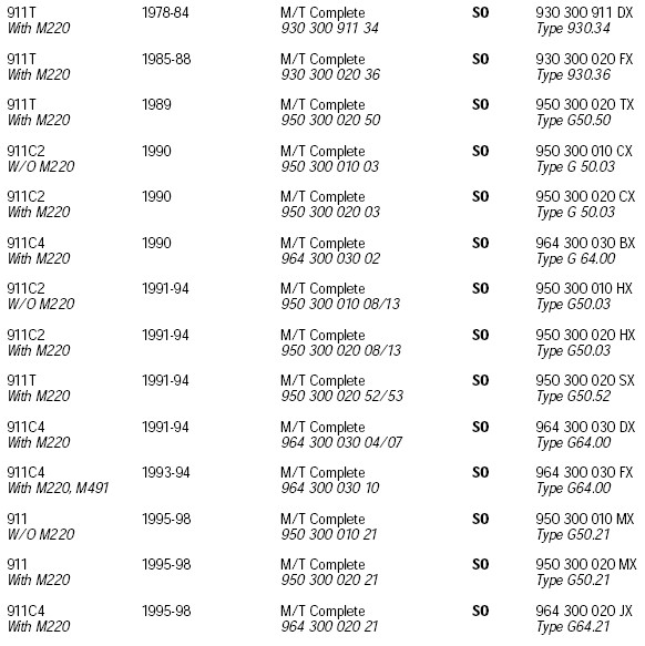

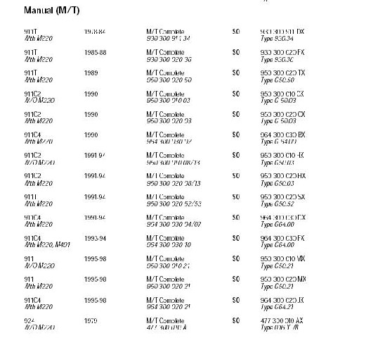

The first attachment is a list of 911 Porsches and their transaxles which I recently found in a rebuilder's catalog. I think it's one of the clearer references for determining which transaxle went with which car.
I have another table which enables one to decipher the code on a G50 or G64 tranny's tag from '89 onward. It helped me recently when a dismantler claimed the tranny I bought was from a '93, when the tag indicated it was from a '91. Unfortunately this table is too big for uploading here, and when I reduce its resolution, it becomes unreadable. Perhaps Ron or Al would have a suggestion for uploading?

Here it is in resolution.
