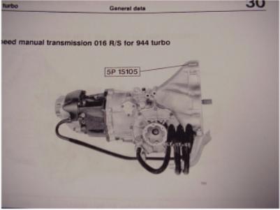

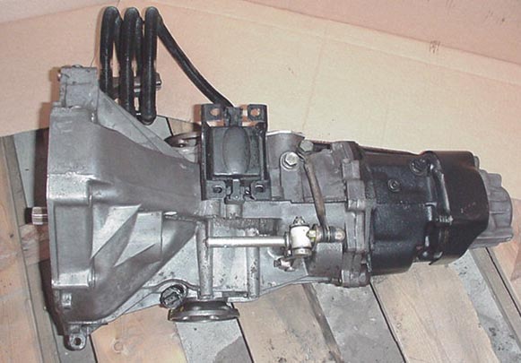

The 944 turbo LSD has 4 pinion gears and different spider gears. Hter is an exploded picture of one. Also, I attached a picture of a 944 turbo transaxle so everyone can see the input shaft and the oil coller.
I'll try again. I don't know what happened to the pictures.

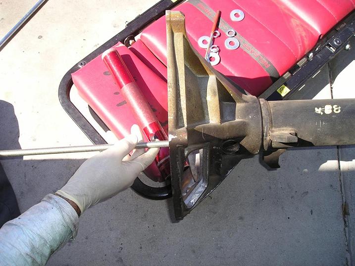

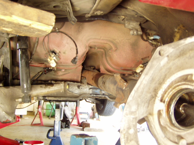

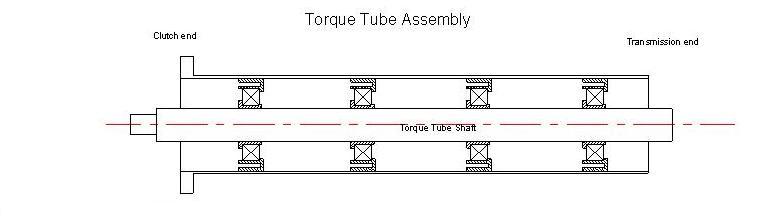

Cliff
Please take no offense from my post, I suppose it came off a little too clinical and re-reading it now I've just clipped myself over the ears....
What I should have said is that there is a substantial amount of older posts that talked about the 944 transaxle and these indicated that the major stumbling block to using it in the 40 was the fact that they had a torque tube that connected the front engined Posche 944 to its rear mounted transaxle. From a "Experts: Porsche Repair" forum, I got the following information
- "The torque tube is basically a rigid housing connecting the 944's bellhousing (clutch housing) to the transaxle at the rear wheels. Inside the housing is a driveshaft supported by three or four ball bearings"
I'll attach some photos, hope they clarify things.

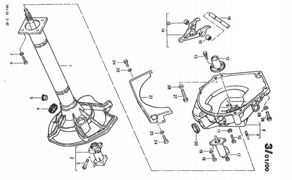

Yup, definitely a torque tube there with the 944 (vaguely remember this too now that I think about it - had a 944 many years ago). I guess the main issue is will the 944 016 bellhousing adapt OK to the common SBF adapters such as Kennedy??? Or, is this bellhousing particular to the 944 and the torque tube arrangement??
Thanks!
http://www.elektro.com/~audi/01E/Por968/
If you go to the above link you will see a close up view of the fron t of an 01E taken from a Porsche 968. The setup of the front housing should be about the same as that on the 016 box used in the 944. You will notice that the box has no provision to mount a starter or clutch fork. In addition looking at the ruler that isshowing the depth of the housing would be a problem to mount the clutch and flywheel.
Peter
The bellhousing shape is the same. I suggested in another thread that you take the Audi 016 case, machine it for the 944t front pinion bearing size, maching the area for the 944t ring gear clearance and machine the 944 input shaft for a pilot bearing. Then swap housings with the 944. You would end up with all of the good stuff and also a 1"23 spline for the clutch disc. Ford and Chrysler used this same spline so you would have an endless selection of clutches to choose from.
