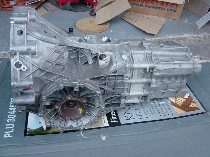

What's this trans ?
Wondering if anyone can ID this trans ? Thanks in advance
Ex:- DRB # 17

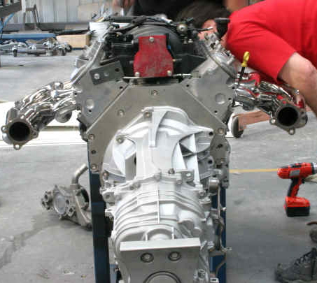

Cool Re: What's this trans ?
strike 2

That would be a Boxster 6 speed transaxle.
Andys
It might be a newer 997 Porsche Transaxle, the Boxster is remarkably similar to the Audi... Either way go and check out GETRAG Corporate Group - 6MTL380 TRANSMISSION and have a look there.
Brett
Brett,
It is the early 5 speed Boxster that is nearly identical to the 5 speed Audi model 012. The 6 speed Boxster in your link is not the same as the Audi 6 speed (01E). That Getrag link is nice as it lists torque ratings of each model; too bad they don't go back to earlier models on thier list.
Andys

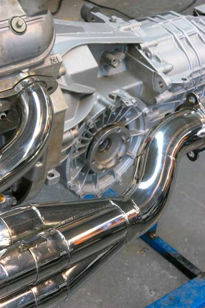

Andy,
Looks very similar to my 01X.
Brett

hey all, (first post here, been watching for about a year or so)
according to an audi freak I know who is a german parts dealer in germany
The 650 tranmission is the quatro one from the RS6 audi
and the boxter 6 speed is the 380 one,
I haven't seen this in real life though
there should be one thing mentioned about the 650nm though, you can put it through, but only in the AWD set up it is used to have, blocking the rear diff would effectivly put all the torque through the front diff and that will give way before the front diff of the 01* does.
grtz Thomas

I believe it belongs to a Porsche Boxter S (986)
