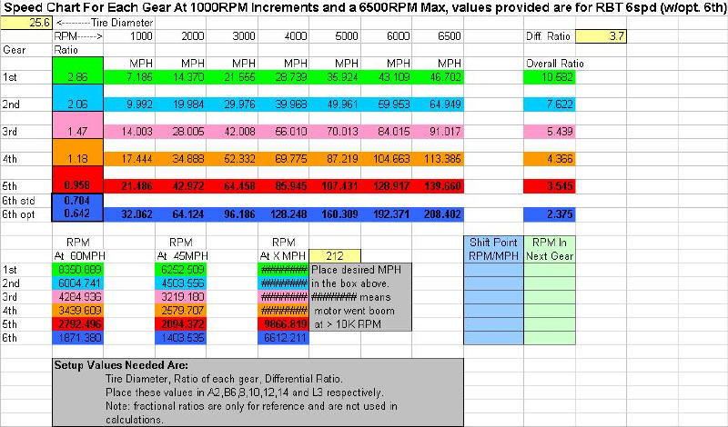

Call Lloyd Butfoy to confirm this, but, AFAIK, there is no difference externally in the RBT transaxles, 5 or 6 spd, from a good ole ZF 5DS 25. Following is a photo of one in a Pantera (Lloyd's actually), which would seem to support my contention:
BTW, Gear Ratios for the RBT-6:
3.7 Ring and pinion
1st gear: 2.86
2nd gear: 2.06
3rd gear: 1.47
4th gear: 1.18
5th gear: 0.958
6th gear: 0.704 (Opt: 0.642)

Here is what the RBT 6 looked like in my little RPM/Speed Tool (attached):

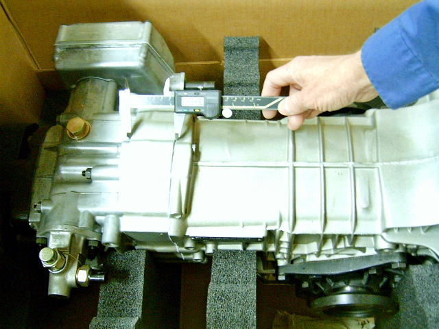

Hi Bernard,
Go with the ZF, good enough to win Le Mans twice, good enough for the Salleen S7, Shelby Series 1, good enough for original spec, good enough for me. Attached is a pic of the ZF/RBT6speed we're putting in a customer car. It's about 55.4mm longer than the 5sp and comes with a reverse switch and speedo drive. Clutches, Bellhousings and Throwout Bearings are no problem.
Thanks for everyone's response. Ian, is it possible for you to do a measurement if you're free to confirm the length between the axle point to the end?
Still waiting for the reply from Xtrac. But the RBT looks good.
I had a look at the FordGT transaxle, it looks smaller than a ZF, yet the dimension spec was 31' in length.
Cheers guys.
Bernard
