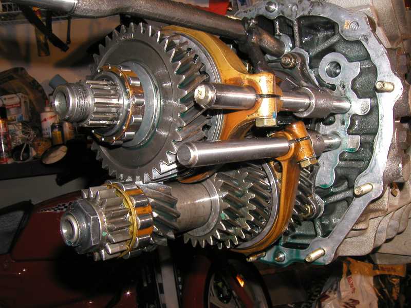

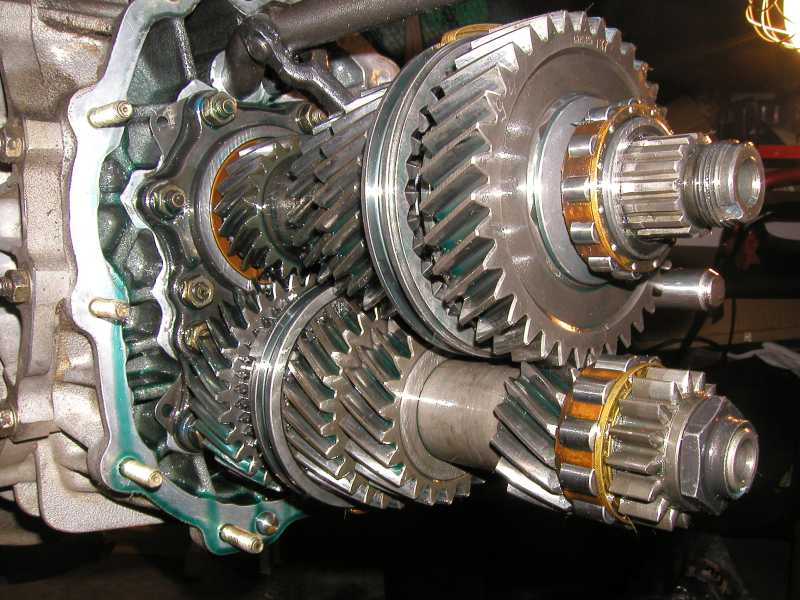

Here a a couple of images of the inside of a 930 before build...
Hard to get a scale on things, but looks like gears are meaty (subjective I guess).
I also got off the phone with Roger at PowerhausII and asked if he has seen a failed (due to blown R&P or gears) 930 trans and said no. The only one he has seen blown was due to a clutch explosion that cracked the bell, FWIW. He did mention that it is a very stout trans with all shafts supported. Most repairs were sliders/syncros.

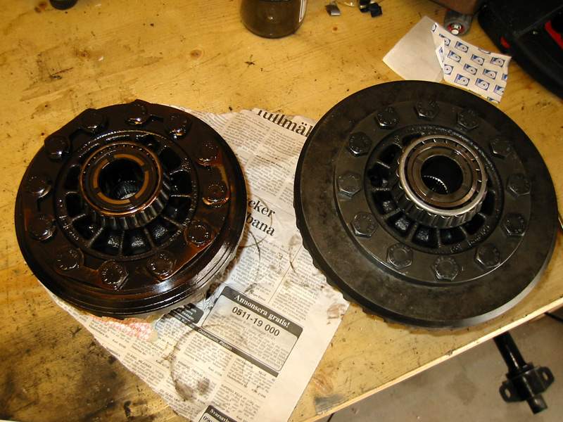

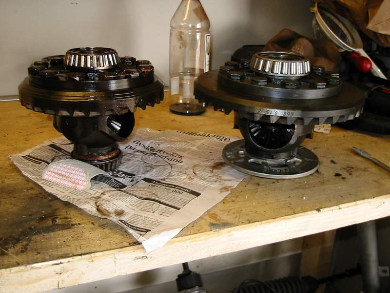

Here are 2 pict's of a 930 diff w/ring gear vs G31 (same as 915) The side bearings are larger too. I seem to remembet that the 930 gear dia. is 9"
Interesting to note the two diff units in the picture.
Heres my observation. I assume the 930 diff unit is on the right, because you said it has a larger crownwheel gear. Correct me here if Im wrong ...
The side bearings may be bigger, that the ones on the left, (915), but there are more rollers on the left side ones. This would give a greater surface contact, reducing the load per roller.
The diameter spacing of the crownwheel bolts is also larger on the left side (915). Would this not give a greater holding torque?
Also of note is the side gear axle diameter. The left unit (915) caters for a larger axle unit than the 930 (rhs).
I also see only 2 spider gears in both the diffs. Obviously this is all that is required but I would have thought there would be 4.
So for me, just from looking, I see that the 915 box could be quite a heavy duty unit. I would guess that its just the crownwheel/pinion size that created issues in the gearboxes that required an enlargement for the 930.
Russ Noble
Rambo Lambo, the smaller number of rollers could just be a cheaper bearing from a different source. That's something to watch with all bearings when sourcing replacements.
I read somewhere, Renegade I think, that the 915 is good for 400 hp and 350 tq but the killer is that all the ratios are miles too low for a V8. And you're right, the r&p is the weak link in all Porsche trannies but so far I haven't heard of anyone destroying a 930. I don't know the size of the 915 r&p but the G50/0x is 190, the G50/5x is 215 and the 930 is 235. My reference (Paul Frere) also states that compared to the 915, the 930 went to heavier axles and 4 spiders, so not quite sure what we are looking at here?
