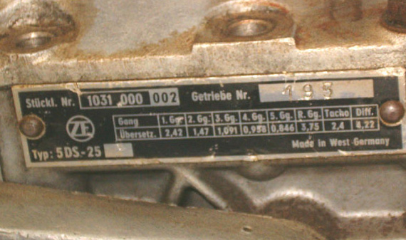

I have a ZF box from an unknown donor car. I suspect it might have been a Lotus 30 or a F5000 since that’s what the development guys had in the shop when they made the switch, but all I’m sure of is that it ended up in my Lotus 47GT. I've enclosed a pic of the ID plate in the box. Could you speculate on what the original car’s identity might have been and the sort of race course it was geared for?
Your spreadsheet is terrific although when I plugged in the box’s numbers and 21.5 “ for the 13” wheels/tires on the car, I was a little disappointed to see a top speed at 6500 RPM of only 131 MPH. But then, with 450 HP in an 1800 lb. car, it’ll get there real fast!

It appears from the dataplate that you have a 5 DS-25 gearbox (as opposed to a -1 or -2 which are much more common). The original 5 DS-25 is philosophically similar to the later versions, but there is practically zero parts interchange between them, making the first-generation (sometimes called the -0 even though ZF never referred to them that way) gearboxes considerably more expensive to repair.

With respect to the source (donor car) for your gearbox, I have no idea. I don't know anything about the Lotus 47; could it have been an original installation? In any case, the gearing is clearly set up for short course work. In fact, your 5th gear ratio is exactly the same as 4th gear in a 'normal' Dash-2 gearbox.
ZF published service manuals (highly in-depth) for these gearboxes; the Pantera Club has reproduced the manuals for the -0 and -2 (what happened to the -1???) in a single volume. If you are contemplating any serious ZF work, or even if you are mildly curious as to how your transaxle works, you can order the book from the club store. Go to www.panteraclub.com and click on the 'club store' button, then go from there.
According to the manual, there were not all that many gearing options available for the -2, whereas there were tons of options for the -0 (both in terms of individual gear ratios, and final drive ratios). I happen to know that the -1 had many more variations than the -2, perhaps as many as the -0.

No doubt about it! Your gearbox is clearly set up for sprint work.
