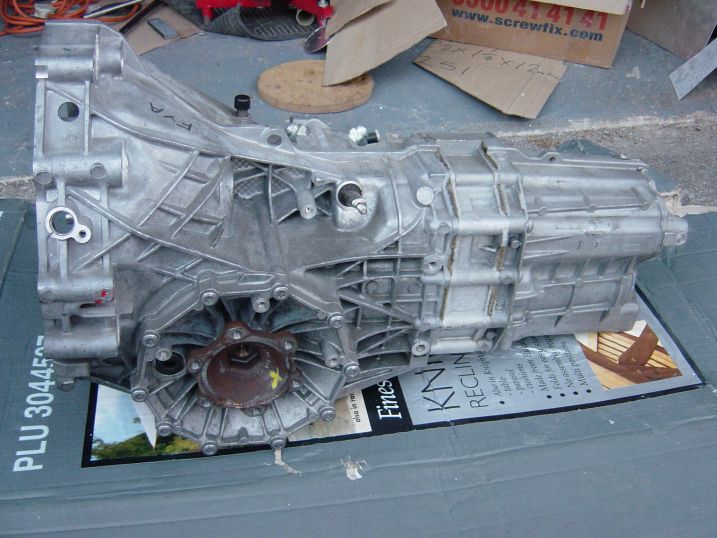

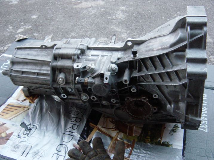

Old 01-17-07, 05:40 PM   #9 (permalink)
brettmcc's Avatar
brettmcc
Join Date: Jan 2003
Location: Essex, UK
GT40: RSGTD
Posts: 1,339
Re: tornado transaxle
One side
ID:	17269   Click image for larger version

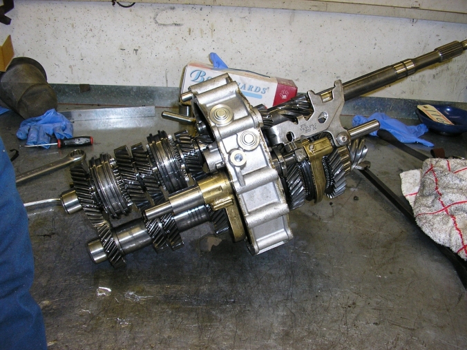

Old 01-17-07, 05:45 PM   #10 (permalink)
brettmcc's Avatar
brettmcc
Join Date: Jan 2003
Location: Essex, UK
GT40: RSGTD
Posts: 1,339
Inside
Name:	inside small1.jpg
