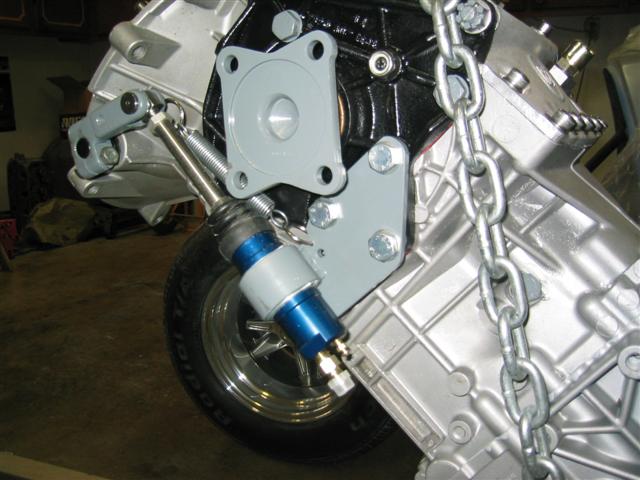

Here is the set up Dennis Quella fabricated for my GT40 ZF that he built for me last year.

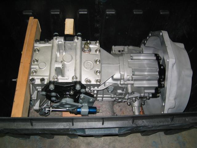

Another shot...

Could you PM me more info on your setup? Did you use the stock arm? What release bearing, slave cylinder, etc.?

Bill, I built a similar system to Rons recently useing an Alfa /Fiat slave, Frank
