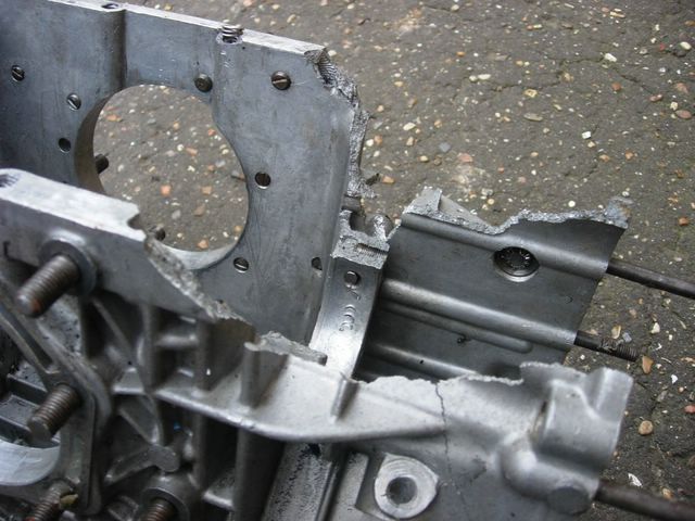

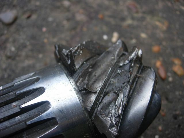

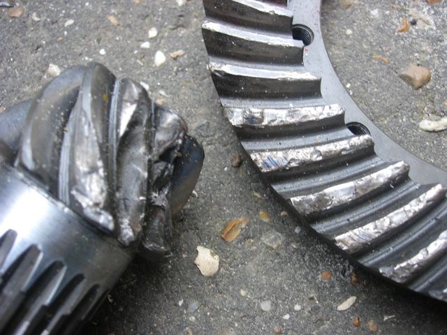

Does this constitute a ZF failure ??

Paul, I'd certainly say so. What were the conditions of that failure and the condition of that box before failure?

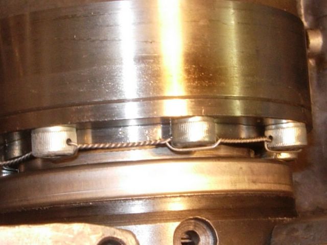

It has been known for the bolts that hold the crown wheel to back out.The bolt or bolts, can harmlessly fall to the bottom of the case or can jam the C&P. In this case it seems the latter may have happened. It is recommended that anyone who owns a ZF have the bolts lockwired.

I believe that this was caused buy a pinnion bearing failure, the bearing seized and the whole lot just let go. There is an awful lot talked about lock wiring the crown wheel bolts, and quite rightly, but equally important is to lockwire the cap head bolts that hold the end plate on the end of the diff. on the /2 diffs. I have had boxes in where these bolts have come loose, the planet gears then force the ramps apart causing considerable damage.

In the pic above the lock wiring is not correct. Rather than try to explain it in words get hold of a 'Standard Aircraft Handbook' and check out the correct procedure.

Jac, I'd love to hear a brief summary of why the lockwiring is not right. The chances of me finding a standard aircraft manual are pretty slim...

The lock wiring should be done in such a way as it is pulling on the one bolt clockwise and going to the opposite side of the next bolt head. (also tending to pull that clockwise (or tighter if left hand thread))
In aircraft the wiring would be done in small lengths (between 2 bolts) and not daisy chained.
And to be picky there shoud be a minimum of 12 twists per inch
In effect the wiring above is only usng the strength of a single piece of wire instead of a double (twisted pair)
Have a look at the safety wiring on the boeing wiper motors - a work of art!

ps. My 2 ZF boxes are wirelocked in the manner you described - the same as JAR requirements and all that.
