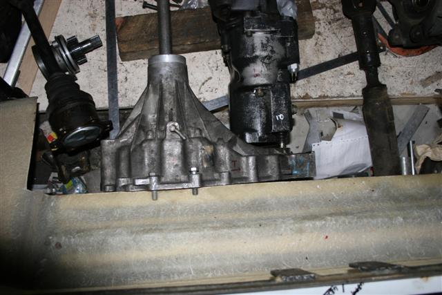

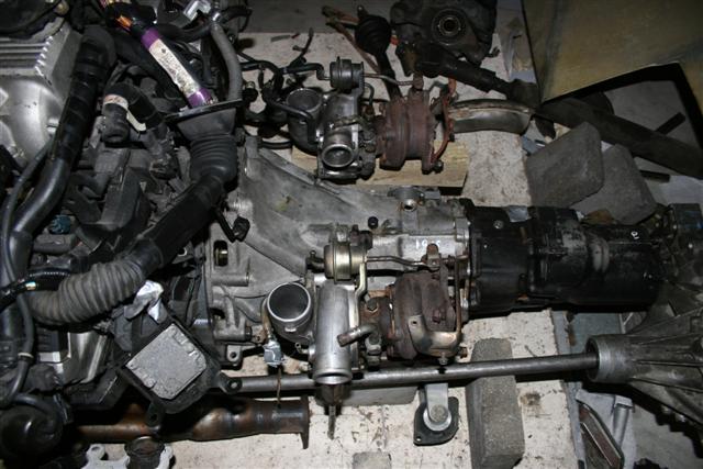

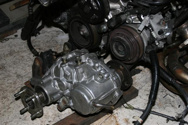

Hi mfox, never ever say it can't be done, how much room do you have from the rear of a 2wd 016 to the rear of the body with everything in place.
I'm doing a Countach with Audi Quattro 4wd, if you can manage 280m from the rear of the std 2wd 016 it can be done, i have used a chain drive assembly from a nissan Torrano 4wd auto that gets the drive from the rear flange of the 4WD 016 facing forward,up the side of the v8 to a Nissan patrol transfer just in front of the v8 and then on up the centre tunnel to the original audi rear diff.and best of all it all turns in the right direction, so i don't get 5 reverse gears lol
