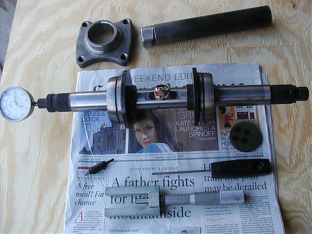

The 385 tool is a must have to set the transaxle up correctly. White lead, dykem, and case works drilled to place dial indicators through are closely akin to pissing in the wind. Even so, lots of "professional" transmission shops set them by guess and by golly. Sometimes they can get away with it.
Picture:
Top left is the needle bearing O.D. "drop through" gauge.
Top right is the needle bearing I.D "drop over" gauge.
The long bar with dial indicator and cone shaped locators is the 385 tool.
Just under it on the right is the magnetic flat plate.
Just under it on the left is the plunger tool that transmits the measurement from ring gear dead center to pinion shaft end to the dial indicator.
To the right of it is a long reach 3MM allen to secure the cones into the main carrier bearings.
On the bottom is the micrometer used to check back lash on ring and pinion as well as individual gears.
Just for grins I placed the tool set on today’s newspaper with my finger ring on the 385 plunger port. I have often asked an "expert" to send a picture of his 385 tool and more than once I have received a picture taken out of the Baum or Zelinda catalog. The newspaper could be duplicated at any time after today but that 2500 year old Shaolin ring might present a problem.
Since I just set up a 935 gear box this morning (same set up as a 930 box) I will take you through the procedure using the dimensions from this one.
Drive Pinion:
There are two numbers scribed on the flat end of the pinion gear face.
The first number (N*) describes the deviation from the end of the pinion to the dead center of the ring gear. This is known as the radius deviation and is specific to this ring and pinion set. It is marked 1- 10 on factory vehicle boxes and 1- 20 on race car boxes. Today’s pinion was marked N2
so I know that the deviation is 0.02mm.
The other number is the match number and it is also found on the ring gear. This set’s match number was 654.
Ring Gear:
One number is the match number as described above and it too is 654.
The other number is the back lash number and on this ring it was marked 0.15. This is deemed the ideal number for this set's quiet running.
Factory design dimension on a 930/935 gear box is R = 82.29.
Add deviation number r = 0.02
This gives me the adjustment dimension "E" = 82.31
Setting pinion depth:
I set my dial indicator to the adjusted R value I got above of 82.31
Next I measured the pinion depth without shims and got -0.14mm
The distance of the pinion face was = 82.15
Taking the total of 82.31
And subtracting the depth without shims gives me - 82.15
Tells me that I needed = 0.16mm in shims
The shims come in thicknesses of: 0.10mm; 0.15mm; and 0.20mm
I added a 0.15mm shim that put me within the permissible range +or- 0.03mm
After the shims are added the depth must be checked again to verify.
Setting the ring gear back lash:
S1 is the ring gear side of the differential.
S2 is the opposite side.
Shims are located under each one of the main carrier bearings.
The backlash tolerance is set by adding shims to the S2 side with no shims on the S1 side until a preload of 56 kpcm is attained with the differential cover torqued into position.
Then shims are pulled out from the S2 side and added to the S1 side (moving the ring gear closer to the pinion shaft) until the back lash is within specs of 0.16mm to 0.20mm.

Only thing that I wanted to add was that for those of you out there that do not have access to the 385 gauge, if you find a higher end CNC machine shop that has a good metrology lab with a CMM you can have the pinion depth measured. Install the pinion gear and leave the ring gear and diff assembly out. Lay the trans on it's side with the ring gear opening facing up. Have them measure and find the center of the large sealing ID on the housing that the diff cover pilots into, then go down and measure and find the center of the opposite side diff bearing cup. Now they can build an Axis through these 2 diameters. After this, have them probe the end of the pinion gear. Now you know the distance from the center of the diff bearings to the end of the pinion. Now you can make shim adjustments as nessary to obtain the correct pinion depth.
A good shop can perform this measurement in about 10 minutes.
