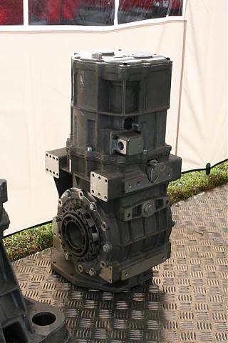

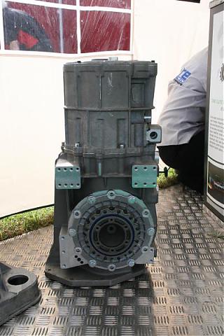

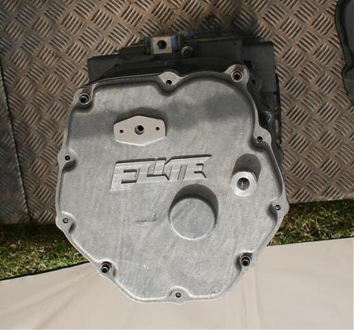

I'd be very interested in your opinion/observations of this Elite Transmission (TXL300-6S)...in relation to GT40 suitability.
John has posted pdf drawings of the unit - although I notice that the drawing is dated 2005 and 'provisional'??
More details available here : Elite Racing Transmissions | beagleengineering.co.uk
Intended power is 427ci 580BHP/560ftlb ('ish) Vehicle weight approx 1100Kg.
Here are some pics as displayed at Goodwood FOS..

Looks like it would work in a Mk4 (long tail section)but a little too long for a Mk1 or 2

Hi Fran -
The pictures might be a bit deceiving as the box is only 0.5" longer than a ZF and the output flanges are within 0.5" of the ZFs too..
regards

A comment on the case shown. By the appearance of the bosses that are cast in the case around the side covers, I would guess that it is designed to be a stressed member; the bosses appear to be mount points for suspension parts. While, to my knowledge, no '40s are designed to take advantage of such provisions, it would certainly speak to the apparent robustness of the case anyway, if not the box in general. If a bell housing designed to support the use of the case as a stressed member were added, it would, in all likelihood, put the overall length of the unit beyond that which would fit in a '40. I guess my point is that the $64K question is, "what do the available bell housings look like?"
It looks like a strong box with some nice features whose price should make it a VERY attractive alternative in the right design. I am just not sure that a GT40 replica is that right design for this particular transaxle.
Lynn

Yes, they do suggest that 'lighter' vehicles can hang suspension off it. Something Ray Christopher did with additional bracing on his UN1 some years ago... (see pic)
As Ian says, it is available in both road friendly (quiet) and straight cut (noisy) versions, but only the straight cut is available as a sequential shift, the road version being conventional 'H-Pattern'.
I know the box is not exactly 'PC' for a 40, but hell, none of these 40s are originals... The owner is very keen to have a fun trackday/competition car and is not looking for 'or
