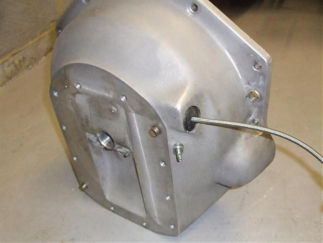

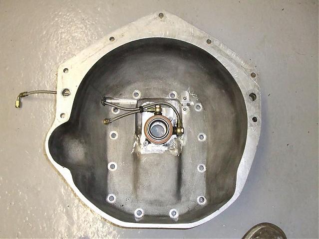

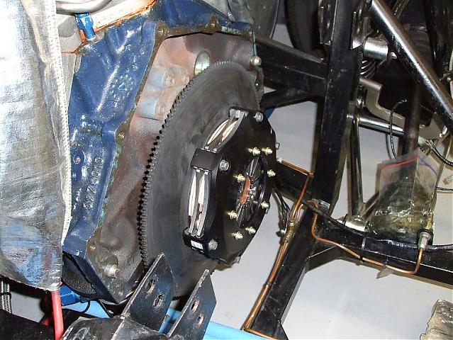

Hi Neil,
I currently have a Chevy 355 with a bell housing that was supplied to me from Chris Cole but to be honest, when I was researching into a bell housing the Tornado bell housing and Chris Cole’s looked exactly the same to me.
I did not have a massive problem with the flywheel, I used a 153 tooth lightened flywheel that took a 7.25” clutch, this I bought on EBay for around £100 from an Ex Nascar.
What you must be careful is matching it to a starter; I was lucky the guy I bought the flywheel from also had a high torque starter that did not cost me the earth, just make sure the offsets are correct and that it is the right gearing.
I have attached some photo's that may help you, one thing I did do is upgrade my Tilton three plate clutch to a twin plate ceramic clutch as I use the car on the street and I did not take allot for me to warp the floater plates and the ceramic clutchs take alot more heat to damage them, so while I was doing this I also upgraded to a hydraulic release bearing this did involve allot of measuring and It is very tight but it can be done.
Chris.

Chis
Thank for the input. I looked at using the 153 toothed flywheel but because I am using the LS1 it has a bolt pattern /flange diameter on the crank.
The belhousing is identical I must assume they come from the same source. I do like the concentric release bearing is it from AP?
We are currently going to add strengthen webs to the outside of the bell housing then we machine 2.5mm from the inside edge .
What do you use your car for that one serious clutch pack!
