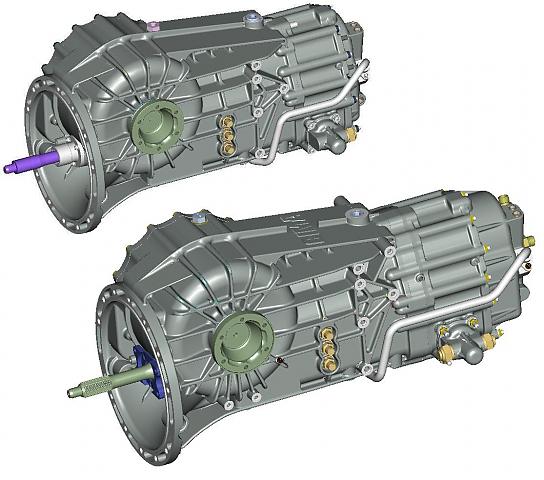

Hi boys,
I have alredy done this job, more or less 250 of my boxes are already installed in cars and about 120 more are scheduled to follow them in the next 15 months.
Some records for information:
Pagani Zonda F - 2nd street legal fastest lap on the Nurbuergring Nordschleife
Koenigsegg CCX - fastest street legal vehicle reaching 388 km/h on the high speed ring of Nardò, speed compensated only up 240 km/h. At 388 km/h with 0.35 G of lateral acceleration.
The most extreme installation LOTEC SIRIUS
1.300 HP and 1.400 Nm
Second to none GUMPERT APOLLO
the German ground rocket with the first synchronised sequential manual gearbox.
Soon or later, but within this year, a T906S will be shown on the most powerfull American Supercar as the replacement of................................(still under NDA)
N.B. All the above mentioned MONSTERS are all street legal.............not single prototypes.
Just to be honest and polite, the first 10 boxes were OK because they were assembled at the development dept. and manufactured under 100% of control.
The second lot of 50 was a desaster. Everything was failing. The 3rd lot was at 30% of warraty claims. Now we are at 5% of warranty claims...........after 250.
Who is attentive and smart will understand the meaning of those words.
In Italy we say...........................to have designed accurtly the MAP of the shits.
I have it and now I know where to put my feets, dear friends.............................
I leave the end of the sentence to your own immagination...................................
just to try my best for not up setting sensitive peoples.
Sorry if Micky Mouse was brutalised. My intention was not to minimise this sympatic boy.
See the attachments.
Regards
Wanni
T 606H versus T 906H versus RBT/ZF
T606H……….T906H
Bell housing face to diff axle 149,3 149,3
( same of RBT/ZF )
Bell housing face to lateral fixing points === ===
( same of RBT/ZF )
Total overall 650 737,5
( 569 is RBT/ZF )
N° of speeds 6 6
( 5 is RBT/ZF )
Flanch to flanch face 280 280
( 280 is RBT/ZF )
As you can understand, the difference is only in the overall length.
569 in stead of 650.
All the other meeting points are similar.
81 mm of difference are justifying 6 speeds and an internal concentric oil pump made for a forced lubrication through the shafts.
A concentric release bearing is also available, with or without electronic control of his position ( this is for OEM supplies looking for paddle shifting ).
That’s the T baby ( T606H ).
It is on his way.
N.B. 600 Nm of input torque capability can easily increase by using Aubert Duval steels carburised at low pressure. 750 Nm are transferable just by using those exotic materials.
Avanti Savoia

Hi Wanni
At 81 mm (3.2") longer than the ZF what car are you going to fit this transaxle to?
Chris.

Originally Posted by Chris Melia View Post
Hi Wanni
Chris.
Hi my fried, here you are.........
81 mm is a huge difference if you considere 2 similar bell housings.
Just to let the forum to understand better, if I am allowed.
Let us assume teoric numbers which are not defined at this stage.
Quaife + 95 mm bell housing and T606H + 60 mm bell housing =
81mm - 35mm = only 46 mm at this stage ( and you know that the drive shafts in the Porsches 911 have 8,5 ° of angle without having any kind of problems.
How I will manage such a short bell housing is the difference between you and I.
You build a transaxle, I build a transmission system and it is where the FOX has his best capabilities by being a vehiculist and not only a transmission manufacturer.
When I wrote that I will make first the LS7 packaging and after the Ford Cobra packaging, the meaning was to supply: Transaxle + bell housing + flywheel + release bearing + clutch + linkage + shifting lever.
46 mm is the same extension of your oil pump.
In the back of my box I have the reverse gear, the small gear is at the bottom allowing a design made in order to make shorter the box in the chassis interference area of about 45 mm.
As soon as I get a GT 40 chassis kindly borrowed, I will show you the latest and last design of it from the back, which you have seen yet.
Why my clutch system shall be shorter of about 35 mm ?
Because some joint venture with clutch manufacturers and clutch facing manufacturers are made in order to develop high tech solutions.
If the Baby T is automated, a new design of a kind of torque converter will take place, replacing: flywheel, clutch and release bearing.
If the Baby T is manual, some new clutch facings, which are in testing now will allow to reduce the actually requested thermic inertia of the system of about 60%.
This means that a single plate clutch without torsional damper ( my input shaft is doing this job by having 1° of torsion every 60 Nm without reaching the spring full compression effect ) of 225 mm, pulled type, is capable to transfer 700 Nm + 50% of security factor. The friction co efficient of this innovative facing is 0.35 - 0.38. Pulled type in order to reduce the depressing load and the hysteresis.
The failing temperature for this system is about 420°C and the disk does not stick slip even without the Marcel spring, helping in axial optimisation.
If you are a Rolls Royce engineer, you shall understand all the values I have written in my explanation.
If Mohammed does not go to the mountain..................now the mountain can go to Mohammed.
Ciao
Albert Wannstein

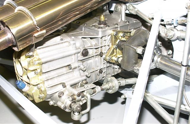

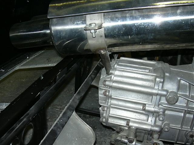

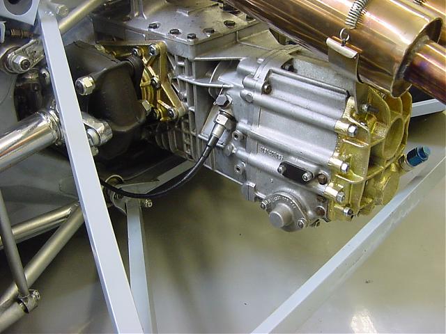

Hi Wanni
So now you are going to use a short bellhousing and move the transaxle forward? This will move the output shafts forward also. Won't work on a GT40 my friend.
The rear cross member on the GT40 sits below our optional oil pump on the ZFQ that why we mounted it high.
If you are saying your baby box is for a GT40 then how is it hung you have no attachments?
I see also that you transaxle is only 600nm = 430ftlbs what is the extra cost to bring it up to the ZFQ's 750nm. 550ftLbs.
Why would anyone want to use your trans and not a cheaper G50 Porsche unit seeing that both will need the same amount of adaptation and cutting to make them fit?
Here are some more pictures of a GT40 (the car in question) so you can see just how the ZF looks when fitted.
I mean you no disrespect but you baby Six speed is not for the GT40 market.
Regards
Chris
A GT40 guy.
