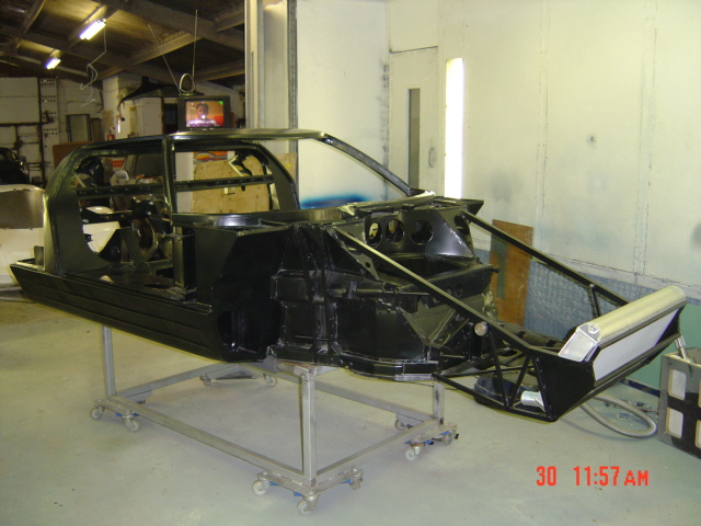

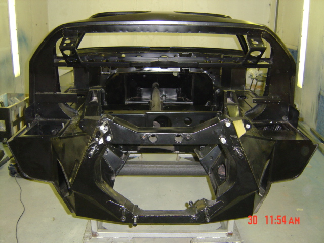

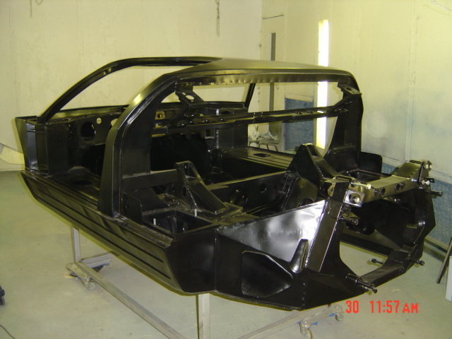

Hi Wanni
At 81 mm (3.2") longer than the ZF what car are you going to fit this transaxle to?
Chris.

Hi my fried, here you are.........
81 mm is a huge difference if you considere 2 similar bell housings.
Just to let the forum to understand better, if I am allowed.
Let us assume teoric numbers which are not defined at this stage.
Quaife + 95 mm bell housing and T606H + 60 mm bell housing =
81mm - 35mm = only 46 mm at this stage ( and you know that the drive shafts in the Porsches 911 have 8,5 ° of angle without having any kind of problems.
How I will manage such a short bell housing is the difference between you and I.
You build a transaxle, I build a transmission system and it is where the FOX has his best capabilities by being a vehiculist and not only a transmission manufacturer.
When I wrote that I will make first the LS7 packaging and after the Ford Cobra packaging, the meaning was to supply: Transaxle + bell housing + flywheel + release bearing + clutch + linkage + shifting lever.
46 mm is the same extension of your oil pump.
In the back of my box I have the reverse gear, the small gear is at the bottom allowing a design made in order to make shorter the box in the chassis interference area of about 45 mm.
As soon as I get a GT 40 chassis kindly borrowed, I will show you the latest and last design of it from the back, which you have seen yet.
Why my clutch system shall be shorter of about 35 mm ?
Because some joint venture with clutch manufacturers and clutch facing manufacturers are made in order to develop high tech solutions.
If the Baby T is automated, a new design of a kind of torque converter will take place, replacing: flywheel, clutch and release bearing.
If the Baby T is manual, some new clutch facings, which are in testing now will allow to reduce the actually requested thermic inertia of the system of about 60%.
This means that a single plate clutch without torsional damper ( my input shaft is doing this job by having 1° of torsion every 60 Nm without reaching the spring full compression effect ) of 225 mm, pulled type, is capable to transfer 700 Nm + 50% of security factor. The friction co efficient of this innovative facing is 0.35 - 0.38. Pulled type in order to reduce the depressing load and the hysteresis.
The failing temperature for this system is about 420°C and the disk does not stick slip even without the Marcel spring, helping in axial optimisation.
If you are a Rolls Royce engineer, you shall understand all the values I have written in my explanation.
If Mohammed does not go to the mountain..................now the mountain can go to Mohammed.

Hi wanni
So you built your baby transaxle and did not base the design on the requirements for the GT40 as you don't have a monocoque chassis this must be true.
I could loan you mine but unfortunately I am using it at present. If you find one, this is what they look like, then you will see why it is important to use original GT40 bellhousing when mounting the transaxle.
Your cable gear change is not suitably reversed to an original style GT40 gear shift either.
The ZFQ is a true nut and bolt ZF replacement, same GT40 bellhousing, same GT40 clutch, same chassis mounting, same gear shift, same starter motor.
