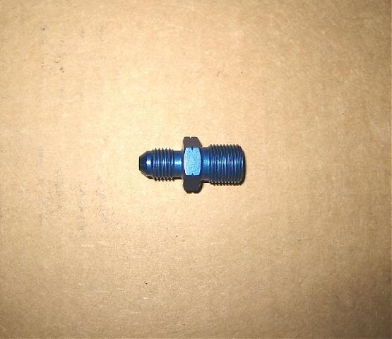

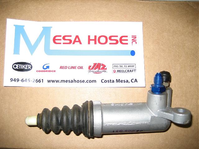

Here are a couple of photos of an M12 x 1.0 inverted flare to AN-3 fitting available from Goodridge. One is of the fitting, the other is the fitting installed into the slave cylinder (Sachs P/N SH1640) along with the vendor information. Goodgidge P/N 306-03-M121D. The -03 designates AN or jic -3; -04 designates AN-4. 'D' designates aluminum; 'P' would be for plated steel.
This vendor claims to be the largest stocking Goodridge warehouse in the US. They are race oriented, and seem willing to entertain special applications. I have no affiliation with them.
Hope this helps,
Andy
