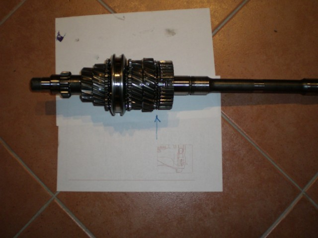

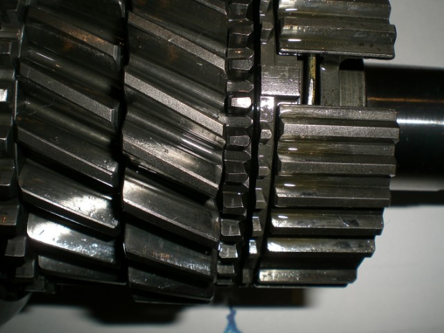

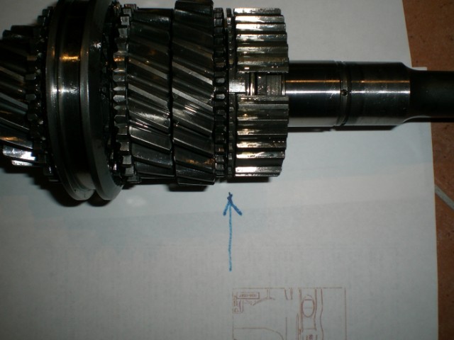

I have my ZF stripped down to replace 2nd gear synchro. Everything has gone smoothly so far but to get to 2nd gear I have to remove almost every component from the input shaft.I'm down to the 3rd/4th gear synchrobody (that's what ZF call it in the manual) which is splined on the shaft.The manual shows a puller for getting it off which looks like 2 half rings and a full ring that slips over and clamps the 2 halves.Then you are able to use a press to pull the gear off.My problem is I don't have this puller and I can't see how it is supposed to work. The synchrobody doesn't have any edge for the puller to seat under and there is only .7mm clearance at the rear of the gear. If anyone can help It would be appreciated.I would be able to have a puller fabricated. Hopefully I can get it all back together for next weekend's race meeting.

Hi Jim, after having another look I see a 1.6mm gap behind the synchro, so I presume you pull the synchrobody and synchro off together.This would explain the design of the puller.The gap doesn't sound like much but I suppose spread around the circumference the lip would be able to pull the thing in a press.

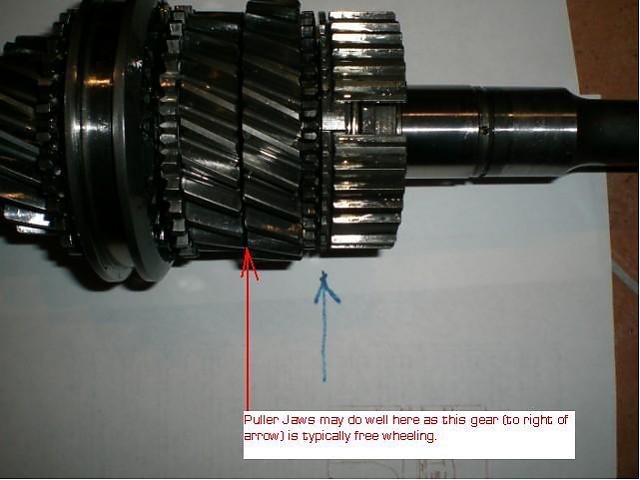

Ross - While I've not been into a ZF Transaxle - I've been Corvette ZF's. Not a lot of joy in the jobs either as everything seemed to be very close in tolerances and there was a lot of custom tooling that had to be made for the job.
I am attaching a picture that may help in the location of the puller jaws. You will probably need to fabricate a pair of half-moon jaws out of 1/4" steel plate as I have in the past. The Slider hub is an interference fit on the shaft and you can many times get by with using a heat-gun on the hub and then chilling the shaft with "Freeze Spray" from your local electronics house - or - use a pressurized can of air from your local computer vendor. Using the pressurized can of air "Inverted" you will get a stream of -200f air to put directly on the shaft thereby contracting it.
This combination of tools (home made jaws, heat, chill) have worked for me in the past.
I hope this is of some & help...
