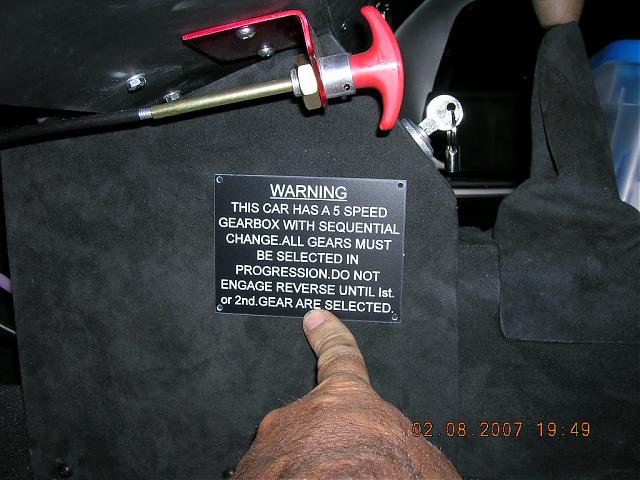

Lynn,
Here is the position.

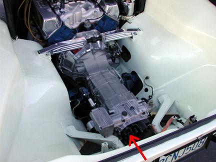

This is the best picture i can find, but you can see the black casing at the end of the gbox, this bolt was drilled n tapped in the same direction as the arrow, concentrically over the idler shaft, once the bolt was removed you simply inserted a punch or a small rod in the hole and pushed the idler shaft back into place and then reinserted the bolt.
This is a good quick fix.
