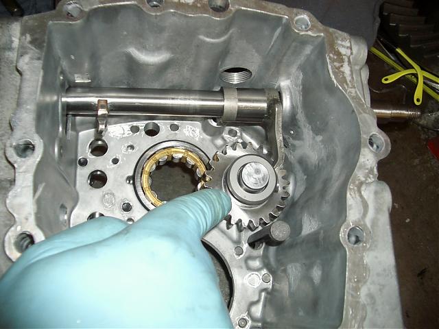

I had it happen when I was reassembling my ZF once.The reverse idler gear is on a short shaft in the rear of the gearbox.It has a sprung loaded detent that holds it out of mesh until the cross shaft is moved to select reverse. I found as I was reassembling the gearbox to the diff/gear housing I somehow bumped the reverse Idler off it's detent.The result was locked box when selecting forward gears as you have described. I have never had any problem while driving the car though and I'm careful when reassembling the box now.Sounds like you will have to take the ZF out split the box off the back and reset the reverse Idler into it's detent.Not a huge amount of work but PIA all the same.

You are very lucky to be in Phoenix. You could have the box fixed locally. Talk to Les, former employee of RBT, (or Mike) at Vehicle Performance Center 602-437-3517. They do a lot of the local Panteras.
I had the same ZF problem. It was traced to an out of spec spur gear & shaft which had frozen on the shaft. Exact same symptoms but it could obviously be another cause. It was repaired by Les with free parts from RBT. I paid the labor. Les and Mike also takes care of the ZFs for 1061. I am out of town traveling this week but good luck with the trans.
Bob

Ah Russ I hope that 930 is reliable. Actually I remember now in my case while putting the box back together and lining up the selector rails, I moved the gear shift cross shaft, which is not a good Idea.In the photo Bob posted you can't see it but there is a pin that locates into the reverse gear selector lever. I had shifted the gear off its detent and so was totally my fault.I can understand how this problem would occurr if the gear seized on the shaft but don't see how that would happen unless there wasn't enough or no oil in the thing. Critisize all you like But I like the box and I can shift it real quick, check my video again if you don't believe me.It was my fault for the missed gear first time on the straight by the way.
