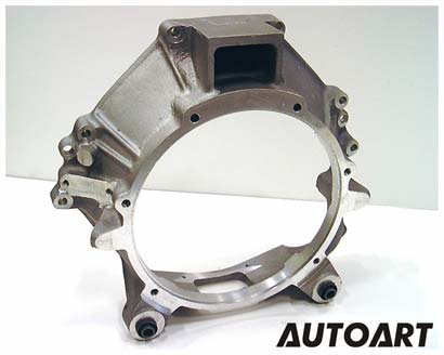

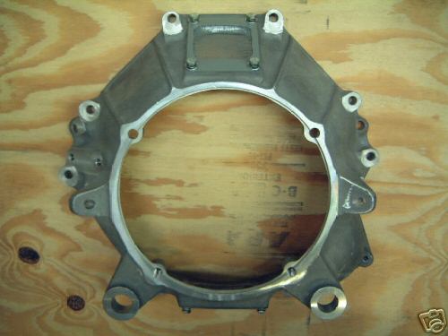

I think a ZF-1 has 4 hole mounting for the gearbox to the bellhousing and a ZF-2 has 6. The photos show this.
Also the -2 was 'beefed up' to take a little more punishment. I dont know if any external measurments are different. Also the ZF-1 is rare and spares will be harder to come by.
Anybody else?
Andy
