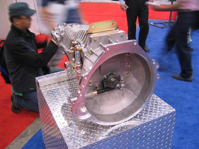

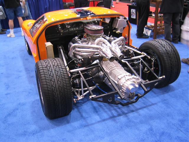

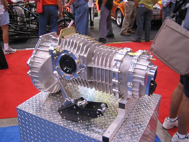

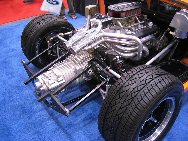

Here's a few pics from SEMA....
ID:	24933  Click image for larger version
ID:	24934  Click image for larger version
ID:	24935  Click image for larger version
