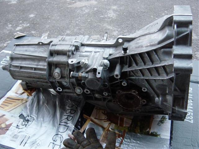

Thanks for the help. Here is a picture of the box.
http://i13.ebayimg.com/08/i/000/ce/d8/8835_1.JPG
Mark

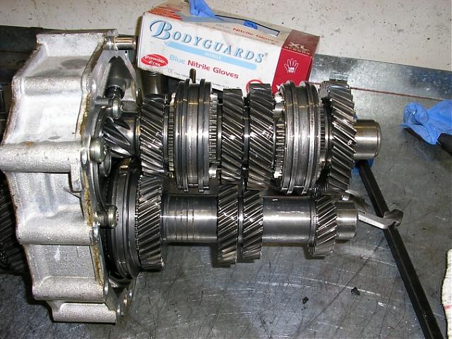

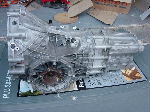

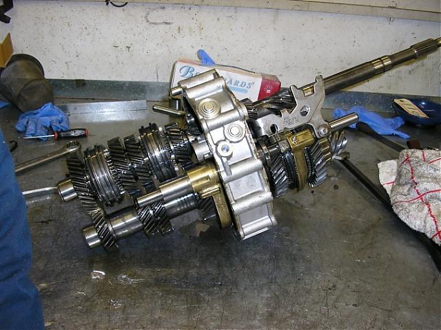

Here is pic of the 01X outside
ID:	26382   Click image for larger version
brettmcc is offline
Old 01-08-08, 11:08 AM   #13 (permalink)
brettmcc's Avatar
brettmcc
Join Date: Jan 2003
Location: Essex, UK
GT40: RSGTD
Posts: 1,339
Re: Audi 2.7 Tdi Fwd 6 Speed
and the bits that matter
Name:	inside small2.jpg
ID:	26384   Click image for larger version
Name:	inside small1.jpg
