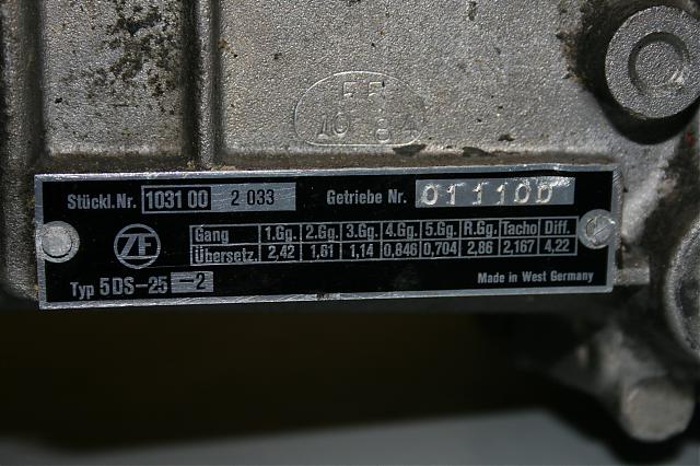

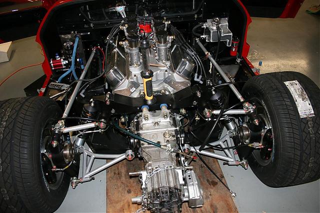

Thanks to you both, I am waiting on my McLeod clutch to show up and then I am ready to put the package together, I have already changed the shift rod and added the knuckle joint and box for the shifter. My best friend said he had read there was a difference but I can't seem to master the search engine on this site.
Here is a picture of it bolted to the block to align everything up. What bearing are you using for the shaft? Whats your opinion on the gearing of the M1?

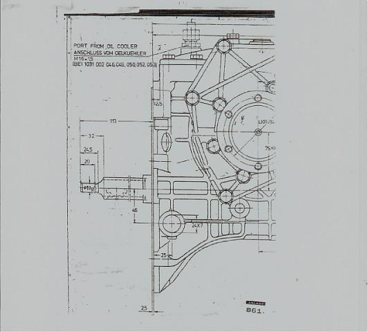

Hi Jack
The length of your input shaft depends on the depth of your bellhousing, the pilot bearing is 12mm and will probably need a carrier machining
regards
Chris.
The drawing below is dimensioned for a 4" bellhousing
