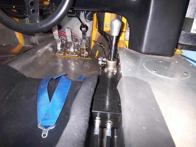

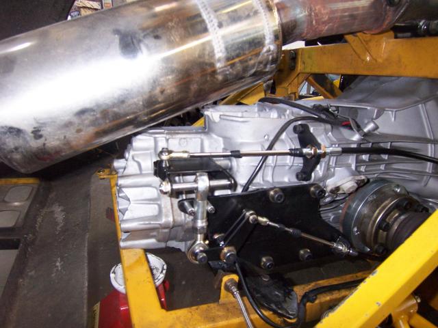

Re: Rod or Cable change for a G50?
Hi Nick,
how about this setup.
A very smooth shift.Not sure if it's the same as your box though.
Will Croll

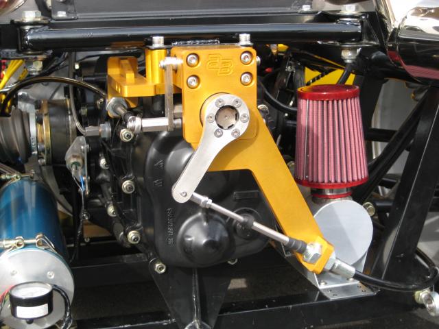

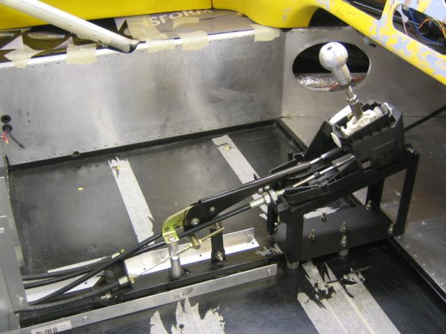

Looks a nice peice of kit
The following are supplied by Steve Austin (yes really) at www.autobionics.co.uk looks like a nice piece of kit.

Nick that shift looks real fast.A really good looking piece of kit.
