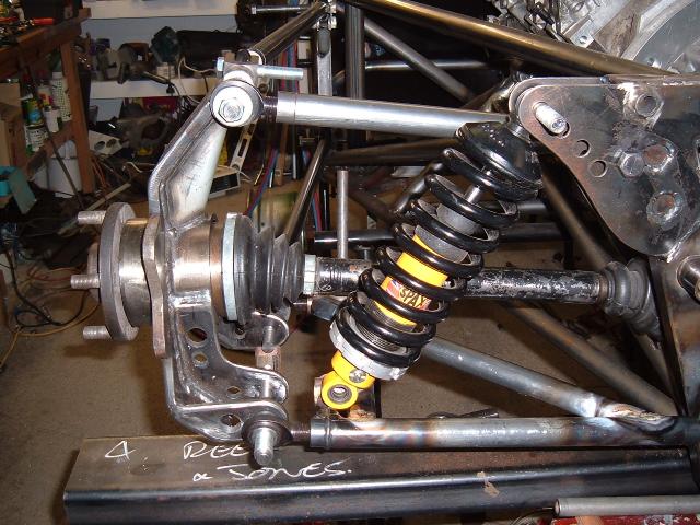

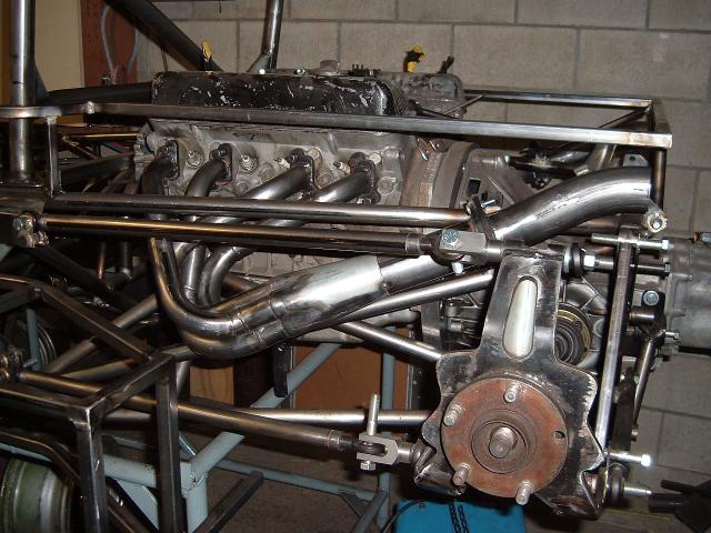

Grant I used the entire Audi drive train in the mid mount set up in my Mclaren. The drive shafts are different lengths and just by luck the longer of the two worked out the perfect length when I found an other one. The wheel bearing is not as wide as I would have liked in comparison to some others but I figured that if it could stand the weight of an Audi front sedan along with all the steering loads, then it would easily cary my meager loads. I bit of lathe work and you have a new centre to fabricate the upright around. I went a little overboard with strength and my Mk 2 ones would be great. With careful design, you could have your attachment points as part of the design rather than bolted to. The picture shown has got my Mk 1 wish bone with a dodgy shock mount which is now direct onto the upright, I will see if I can find another picture.

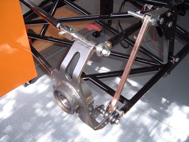

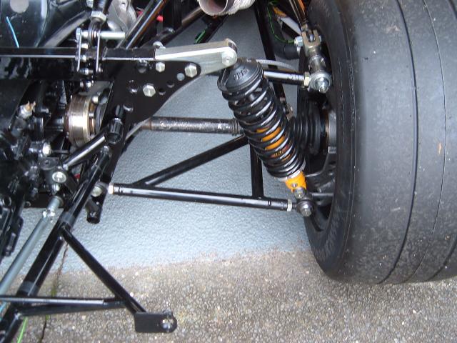

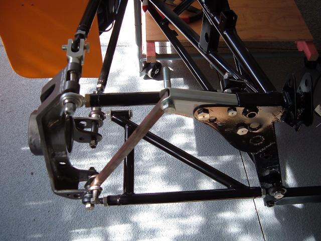

These shots shown the new set up more clearly. You can see where the new shock mounts on the upright.

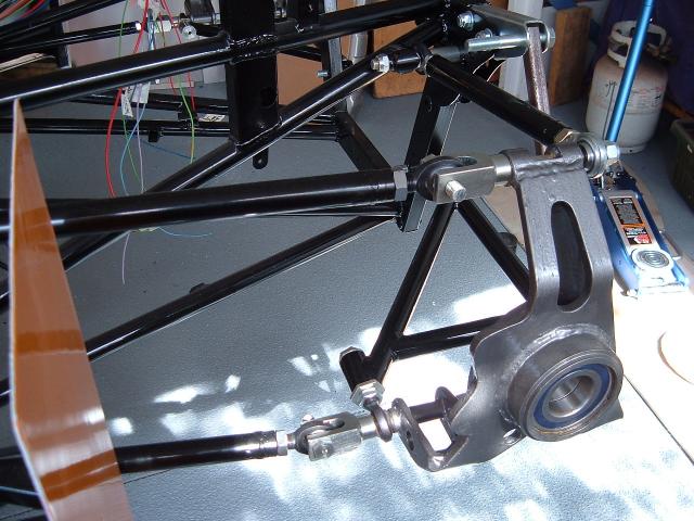

Grant
The methode I used was to turn up a centre section tp press the standard Audi Bearing into and then fabricate the upright to the centre with the appropriate mounting points. I did a final bearing fit once I had done all the welding and fabrication, using a wooden dummy bearing for dimensions. As I said earlier, my first ones are `strongly` constructed and could easily be improved on.
