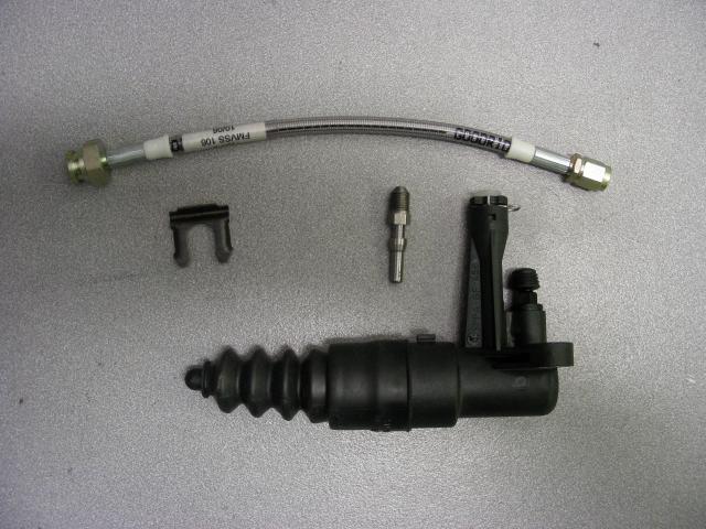

Hi Brett,
I don't know if this is what you mean, but it may help. We use a fitting which clips into the quick connect in the slave, onto which you fasten a std -3 braided line. Saves our guys purchasing the (expensive in Aus) OE Audi hose.
I can mail the fitting itself over if it will help ?
Regards Paul

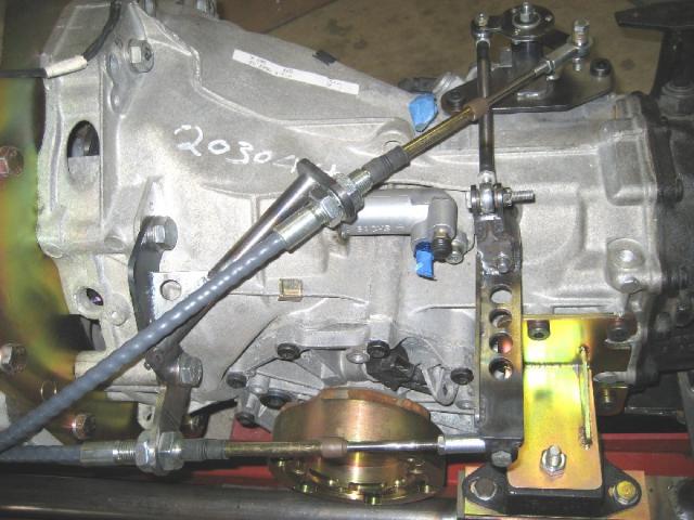

Originally Posted by lonesomebob View Post
I believe the original post was asking how to adapt to the quick release type fitting found on mostly the 01E (plastic) slave. Since at the time I was unable to find such an adapter fitting, I used the slave from an Audi 80/90 (US) which fits the 01E, hence I located the appropriate Goodridge adapter fitting to mate that slave to a -3 (or -4) hose. Below is a photo of the slave I used for the 01E with the Goodridge fitting in place (Barely visible; the blue fitting with blue tape on it).
I may purchase the adapter fitting from The New RF as a back up for the future.
